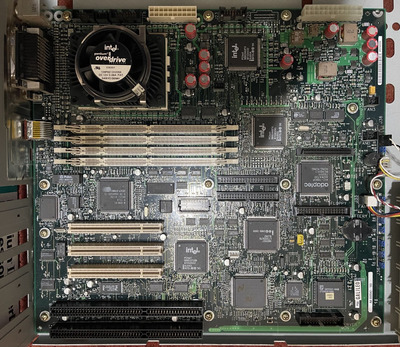

Reply 56 of 156, by TrashPanda
Just realised OPs socket 8 is only 72 pin Simms, mine is 168 Pin EDO ECC Simms which I initially thought were SDR PC66 modules as the EDO ECC modules look identical except for the first notch being slightly closer to the outer edge.
Perhaps this is due to mine being a 440FX.
Wonder if my board support buffered EDO ECC ..only one way to find out I guess.
Reply 58 of 156, by TrashPanda
Irinikus wrote on 2022-10-16, 21:02:
This board is based on the Intel 82440FX three chips PCI set and it has ECC support. […]
Mines a NEC job with integrated SCSI, Video and a few other server related things, seems 440FX came with a wide range of memory support.
608.37 KiB
741 views
Mine
182.73 KiB
741 views
Mine
You can see why I thought this was PC66 SDR
