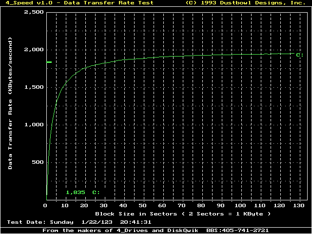

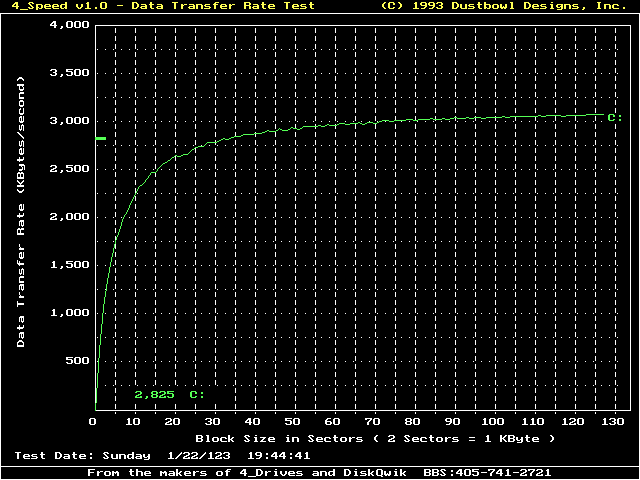

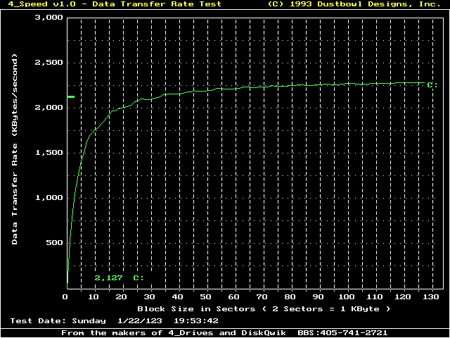

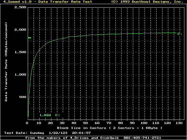

Reply 81 of 90, by zyga64
Unfortunately none of Norton SysInfo versions I have was able to recognize my HDD (Conner Peripherals CFS541A -540MB) and thus test performance.
But I did benchmarks using PC Certify Pro 6.0 and 4_Speed 1.0 by DustBowl Designs.
7.14 MHz is default ISA clock (with BUSOSC soldered back to PCB 😀
PC Pro 6.0 results:
                          | 20 Mhz | 10 MHz | 6,67 Mhz | 7,14 MHz (default)
Track To Track Seek (ms) | 4,1 | 4,1 | 4,1 | 4,1
Average Seek (ms) | 13,4 | 13,1 | 12,8 | 13,5
Maximum Seek (ms) | 47,5 | 47,5 | 47,5 | 47,5
Access Rate (kB/s) | 442,1 | 386,8 | 378,9 | 378,9
Transfer Rate (kB/s) | 2367,7 | 1894,1 | 1515,3 | 1515,3
4 Speed results:
6.67 MHz - 1822 kB/s
7.14 MHz - 1835 kB/s
10 MHz - 2127 kB/s
20 MHz - 2825 kB/s
    4.63 KiB
    579 views
    4.51 KiB
    579 views
    4.39 KiB
    579 views
    4.4 KiB
    579 views
1) VLSI SCAMP /286@20 /4M /CL-GD5422 /CMI8330
