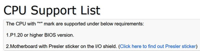

One question tho, it states that Preslers are supported but:
30.27 KiB
1530 views
pres
Does it mean both 1.20 BIOS + Presler sticker are needed, or does Presler sticker imply it's already flashed for Preslers?

Bump for this explanation (is it both, or either/or)?
30.27 KiB
1474 views

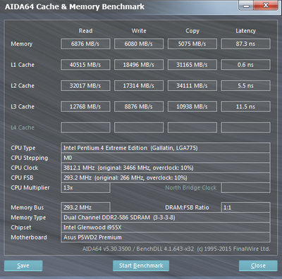

TrashPanda wrote on 2022-12-05, 15:59:
Yup slow as shit L3 cache, it should have been on the order of 30% or more uplift over Northwood but Intel cut corners and stuck it with 512kb of L2 instead of 2Mb. 15% uplift over Northwood really isn't that impressive when looking at actual real world numbers when Northwood performed terribly out of the gate. However you could clock the snot out of Gallatin due to the unlocked multi to make up for the deficit if you have the cooler that can handle the ~110watt TDP.
I actually don't get why they went with the slower L3 but I suspect its because Gallatin was a Xeon variant of the P4 ported to the consumer space to give them some breathing room to get Presshot out, in any case Gallatin never saw use outside of Extreme edition CPUs.
One other point to note about Gallatin .. it didn't have SSE3 or x64.
Not sure how L3 is supposed to be slow on Gallatin (it's clocked as fast as core is FYI), but relative ratios of bandwidth (comparing L2 to L3 to DRAM), are quite similar to L3:L4:DRAM ratios on 5775C :
196.11 KiB
1440 views
You can't just quadruple L2 size because "it can fit" on your newer node, die cost will simply be too high. Intel didn't "cut corners" with Northwood, they simply "fixed" what was wrong with Willamette, and added 256kB more L2 because of newer node margins.
Gallatin/Prestonia cores were designed for server use ONLY. They were never meant to be used in todays i5- or i7-range of products.
Only after Athlon64 came along, we got first Pentium 4 Extreme's.
ALL Pentium 4 Extreme Edition CPUs DO NOT have unlocked multipliers - and this is the case for all platforms they can be bought for. First officially unlocked (up and down) Netburst Intel's CPU is Pentium Extreme Edition 840. I don't count prototypes or ES'es here, because they aren't meant to be sold.
Lastly, you can't "disable" one of the dies of Pentium Ds in 90% of LGA 775 MBs (and only Intel manufactured ones, usually have this option [if they support multicore CPUs]). At best you can soft-disable either one from OS (msconfig/Advanced/CPU Processors selector).
But this doesn't power off the die, as OS simply ignores it.
Yesterday I bought Pentium D 945 3.4Ghz for 2$ to test it in my 775Dual-880Pro motherboard without Presler sticker. It works fine! In Windows 98SE I get more scores in 3DMark 99 and 3DMark 2000 than with my Pentium 4 541 3.2 Ghz.

ASRock 775Dual-880Pro Revision 1.04 WITHOUT PRESLER STICKER, BIOS version 1.70

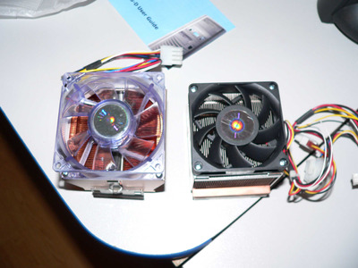

Also, top 5 775 coolers, and top 5 478?
Any way to retrofit a more modern cooler ala 212 EVO (random example) to 775 or 478?
Top coolers : (in photo) , I use to use a Zalman 9700 worked on 775 and 478 , a 9500 is also acceptable , if you want more cooling be sure to sand down the copper from cpu & cooler , (or) delid them - change paste on die.
P.S. Some older Dell bios'es let you disable multicore function from bios , so no problems there (os will see 1 core), only issue is that you wont be able to do much O.C. on dell. (some soft oc from soft maybe) but mostly 0 or less from bios.

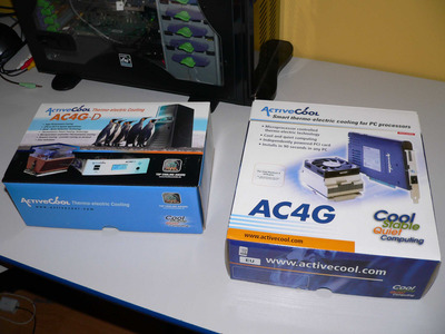

tuniq tower 120 is the best socket 478 cooler I own.
83.71 KiB
