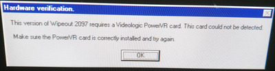

Hey does anyone know how to get wipeout 2097 working with the pcx1?
It asks for a videologic apocalypse but I've got the japanese version of the card made by NEC , I'm assuming that's the problem?
Is there any workaround for this , to get the game to run in SGL?
Reply 1 of 15, by AppleSauce

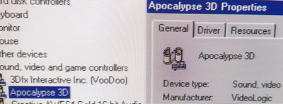

Here's a picture of the error and proof I've got the drivers working.
I've even tried different drivers but no dice.

It's Direct3D, there is no SGL version. He is probably trying to run the bundled version from a Videologic card which has a PCI ven blocker in the code. There are example of other bundled games with the same limitation.

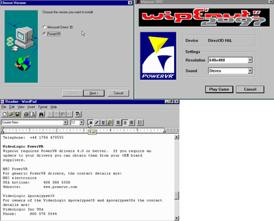

How come the installer differentiates direct3d and powervr then?

Maybe there's a way of spoofing the exe via disassembly or hex editing?
Reply 7 of 15, by dunzdeck
AppleSauce wrote on 2022-10-20, 14:28:
I certainly hope that's not the case , but companies have done stupider things.
I'm certain it's fairly easy to bypass the check that throws up the initial MsgBox shown. I've certainly done things like that before with little more experience than IA32 assembly knowledge. Just NOP it out or if you're really lazy, flip the JNE into a JE ;P

AppleSauce wrote on 2022-10-20, 14:26:
Wipeout 2097 was a PowerVR Extreme rated title. That meant really high compatibility and good performance. Direct3D titles are alittle hit and miss on the PowerVR cards, and many games require you to select the right settings in the drivers. I'd love to be proven wrong, but from what I remember when I tested this back 10 years ago, the PowerVR install option is an optimized executable for PowerVR cards, but it's still running in Direct3D.
I'm pretty sure the hardware check could be removed with hex editing, like I did with Destruction Derby (and have been done on other bundled games by others).
Yes that's exactly what it is: Direct3D tailored to run on PowerVR cards, there is no SGL.
Oh wow that's lame , I was under the impression it used native SGL. I guess ill just stick to using my Voodoo to run the game since its using direct3d then.

Yeah I noticed if I ran the powervr card in HAL mode the screen would flicker like crazy , I guess because the two cards were fighting for control over 3d rendering.
So yeah removing the card would probably be necessary if I wanted to run direct3d with the powervr.
If I leave the powervr card in native mode , but try to run the regular exe not the powervr one then the voodoo works fine.
I might still try bypassing the exe for the hell of it , but id imagine it would be a similar issue , still if its not a native game I'm not super keen on bothering with removing the voodoo.
