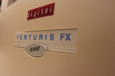

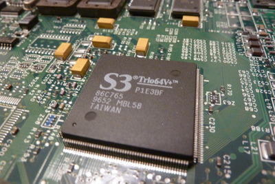

A little while back I've got remains of this Digital Venturis FX5150
202.26 KiB
2814 views
This is an interesting tank of a computer. So heavy that I can barely lift it, real nice computer for a much needed work out 💪
I wish I could tell something about Digital brand, but the only stuff I know is that it once was one of the larger OEM's, which managed to even produce it's own processors at one time, but later was swallowed by Compaq. And my machine is one of the later models, thus feels somewhat similar to Compaq, while managing to have a slight edge over those. There for, if some of you could share some interesting trivia, it would be great!
My story with it begins when I've got it's motherboard from my evil friend to try and sell on Ebay or something... Yet, somehow, it newer made it there and it was just laying around for a year or more. Until I've found out that there is also a case available for it. It was then quickly decided to rebuild it. And so I've done a simple and honest revival of it. That means, just clean it, gather few missing parts and put everything together in an authentic fashion.

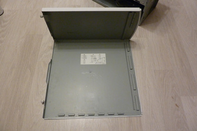

These PC's were available as Desktops and Short Towers, which are very slightly bigger than your normal mATX. Yet, their design is very unique! And while I'm not usually fond of unique OEM stuff, this one seem to be unique in somewhat positive way! Although there are a few negatives as well.
291.72 KiB
2814 views
308.21 KiB
2814 views
265.83 KiB
2814 views
As you can see it is does look pretty normal and I like that. It has 3 5.25" bays, there is no facia for a floppy drive, which is good. It uses standard ATX power supply, which is even better. The only negative for me is that case opens from a wrong side. At least for my desk setup, this can be quite annoying if I'll have to tinker with it while using it, but when it's fully done, I guess, this won't be such an issue.

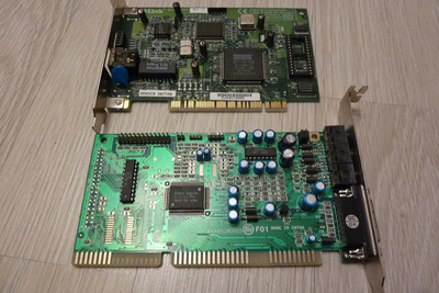

I have found a few humble cards to go with it. A D-Link LAN adapter, featuring Chipset from Digital (this looks to be a rebranded Intel card). And a simple ALS100 ISA Sound Blaster compatible. I'm sure this wasn't an original card for it, most likely it might have been equipped with some ESS card (at least judging from a manual). Yet, this one should be good enough:

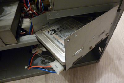

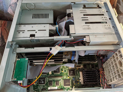

And this is one of the neat features of the case, the whole hard drive bay can be pulled to the side and removed easily if need be.

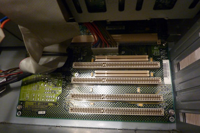

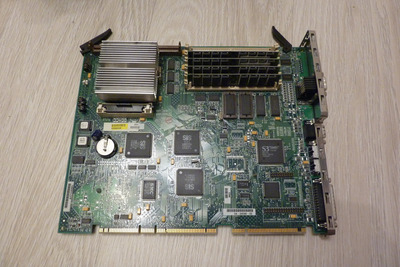

Motherboard is actually split into two parts. There is a lower part which is attached to the lower part of the case and held securely by screws. Most of the stuff, all the drives, LED's, PSU and IO cards then can be plugged into this part.
381.66 KiB
2799 views
Penguin Workshop
https://viekelis.lt
Reply 2 of 45, by totoro
Then the upper part of the motherboard slides into the case by using a system of rails. Quite interesting and unique, it was also possible to easily upgrade a motherboard to a slightly newer one, which also featured SD-RAM slots and USB controller and a Chipset more optimized for an MMX CPU. But upgrades ended there as shortly after there was no Digital no more...
474.06 KiB
2789 views
And just like that, with an insertion of a motherboard, the system is live again!

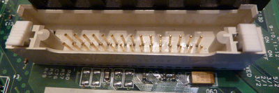

Oh, by the way, on my motherboard, just below a CPU, there is this socket, do you happen to know what it is and what it's for by any chance?

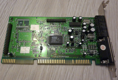

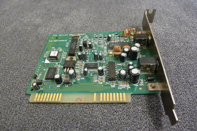

Then an appropriate sound card. This is an ESS ES1898F which seems to be pretty much the same as 1869F (it is even detected as such in Windows 95/98/XP). But this features a 3D Spatializer, which is one of the highlighted features for this Venturis FX5150s PC. Well at least this feature tend to be highlighted in the manuals and other press. And it does enrich OPL sound making it sound just a little bit richer and maybe even a tad bit midi like. It also features a Wavetable heder (which was also advertised) and a bugless MPU401/Game port. I think that'll make this build feature complete.

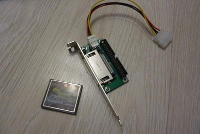

Another thing is storage, the BIOS/E-IDE controller on this thing is a bit picky and troublesome. It is also capped at ~8GB of maximum hard drive space. So my options are limited, I could use that semi period correct 4Gig WD drive, but I can barely stand the noise. So I'll probably install something on it and then keep it disconnected. That leaves me with other option, yes, a CF card!
612.28 KiB
2465 views
With that it is now dead quiet! I can hear the fly flying by. I could even modify the bracket and fix it in one of two special holes at the top of the case, that would free up an IO slot, that's even better. I'll need to invest into bigger CF cards tough. Or, maybe, I could even use two adapters. But I don't know, for such a tanky machine as DEC, the CF almost "does not feel right". I also have an Adaptec PCI SCSI controller and a free PCI slot, so maybe I should search for some SCSI drive? Or... I also do have a Silicon Image UDMA133 PCI IDE controller card, which should allow me to use a bigger SSD drive and bump storage performance quite a bit (as an integrated controller is only capable of PIO4).

As for that socket, looking at the service maintenance manual I think that would be where a voltage regulator module plugs in if you're using a 166 or 200MHz CPU. The part number for this would be 54-24516-01. For a 133Mhz or slower CPU, it should have a connection shorting block installed instead (part 12-46680-02, 54-24040-01, or 12-46680-01).
That makes sense! So, apparently, if I'll want to use an MMX CPU, I'll need that regulator. And yes, the socket is currently plugged with some plug. Interestingly, I've tried to install 166Mhz MMX CPU without the regulator some time ago and it seemed to work fine, but it was running way too hot, now I know why 😆

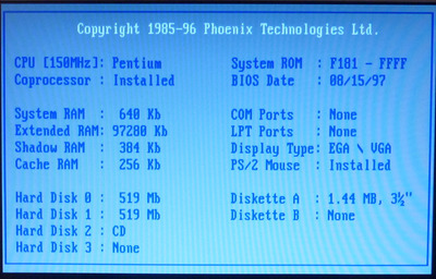

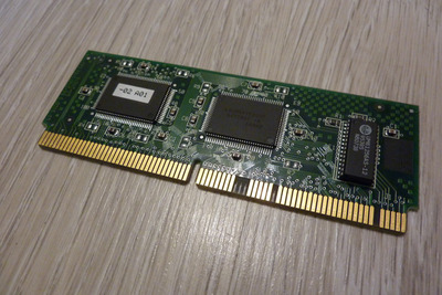

It is a bit of a mystery to me on how exactly this PC mages it's caches... The motherboard does have 3 chips of 128k, so a total 384k of cache memory available. This cache is referred by BIOS as Shadow RAM and I have no clue what that actually means. Is it possibly only for shadowing Option ROMS (like BIOS, Video BIOS, LAN and other stuff that is in between 640k and 1024k mark)? As the PC works just as slow as without any cache at all. There is no difference on how it operates with all cache disabled. Any test utilities or benchmark programs do not see any cache and memory performance is just flat all the time. I've remembered that this motherboard originally had an additional 256k on a removable module. I have then removed this module as it was giving me lot's of trouble. The PC was very unstable, it crashed all the time and other times it would just randomly hang. So I figured that the cache module is faulty and have thrown it into a pile of other electronic junk. Somehow, I've decided to give it another go, only this time I've tried a very stupid easy fix - cleaning contact pins with some iso-propyl alcohol 😄
398.72 KiB
2399 views
And hey, it seemed to work! The PC instantly got a nice performance bump. I can see it being reported as a Cache RAM all the benchmarks and testing utilities report that system has 256k of Cache. Most importantly, PC did pass all the benchmarks that I've tried to run on it and so far so good, not a single hiccup while using it normally or playing with it. So I guess this is a big improvement!

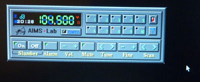

FM Tuner
506.08 KiB
2393 views
I just love this little 8bit card! It's an FM Tuner, which works very well under DOS and Windows 9x. The driver is very simple, it just activates the card, dials into wanted frequency and leaves it playing in the background until reboot. There is also a GUI program, which allows to save favorite stations into the memory and looks pretty. The card has line-out and antenna input and that's it. Very basic, very simple. It sure brightens up an experience!
