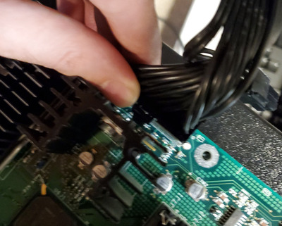

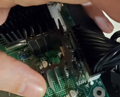

Does it support the integrated S3 ViRGE? The video ROM is probably part of the BIOS.
The orientation of the ATX power connector is brain damaged.

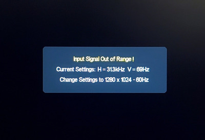

There is also another issue with the S3 video chip. When the CPU bus is clocked at 50 Mhz, my LCD will sometimes be unavailable to sync with it. This occurs after the BIOS screen when the system starts to boot the OS, and can be mitigated by entering the BIOS and then proceeding to boot after exiting it.

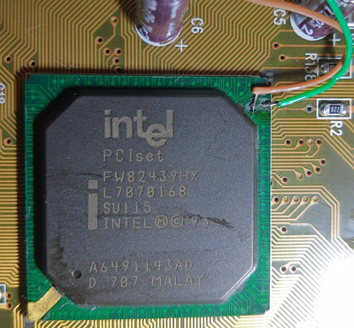

and to add some fuel to the fire, theres two ways the CELP slot could be wired.
1 with the traces for the second tag ram
2 without the traces for the second tag ram.
So you can't always just wire to the TIO lines on the CELP instead you can solder to the chipset and that'll work! after some bios mods.
Be Happy, it's only going to get worse.

Reply 36 of 78, by Kahenraz
That sounds terrifying. Soldering onto the chipset, and modifying the BIOS on this board. I'm afraid to touch this BIOS, since it isn't a chip I can put into my programmer.
Reply 37 of 78, by CalamityLime
oh yea, yeah it was.
Worked though.
It's also a great way to introduce weird ram errors if you're using sockets that are not spotless.

I managed to fix the overbright issue by flashing another BIOS using shadow ROM with svbl.
Luckily, this tool specifically supports the Triton chipset (Intel 430HX). Here is the command I used:
svbl.com /c:triton.cps /b:86C375_5.bin
Neither s3bright.com nor s3black.com worked with this onboard card. I know that these utilities work with other cards, since I have tried them in the past with my S3 Trio 3D/2X.
I've attached everything needed to get this working, in case anyone else finds themselves with this same problem in the future.
