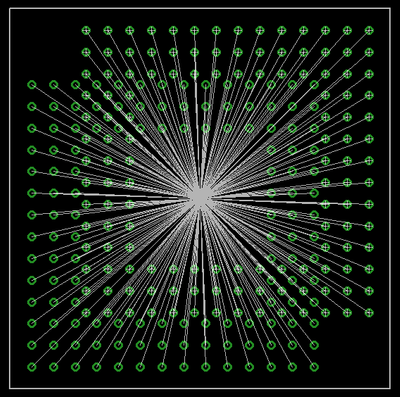

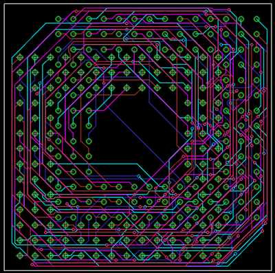

I thought this was an interesting idea, so I plugged it into eagle to see what it would do. If you just rotate the pins and hook each one up then it can easily route in 4 layers. It will also route in 2 layers, but the board needs to be bigger. Using surface mount parts is probably how I would do it, but I also tried a thru-hole version with the grid shifted over. I don't know how hard it would be to assemble this, but Advanced Interconnections makes a variety of parts that could probably make it possible.
I was not sure on the pin grid pitch so I used 2.54mm and used your picture above to get the 132-pin arrangement. This was just to see if it could work, so there are certainly tweaks that could be made to the design rules to put in more copper, etc. There could also be improvements by going through the specific pinouts, but another possible advantage of routing/rotating all 132 pins is that there is no "Pin 1" and with the shifted pin pattern you could also rotate the adapter to both shift and rotate the chip as desired.

Reply 26 of 116, by Sphere478
Beautiful!
2.54 is correct I believe,
Those nets look exactly like I visualized them.
The image is kinda small on my phone, and I am unfamiliar with eagle is that all connected? Do you intend on finishing this? Do you consider this just a draft or something you can tweak to compleetion?
I was imagining issues with too many vias everywhere to connect to the smd pads. I had intended on routing on the internal layers as much as possible but I suppose routing on the top and bottom would save a lot of vias for smd setup. 🤔
How do your floods look? Or will you need extra layers for it?
Being that the problem is so geometric, I was hoping for a symmetric solution a pattern to the routing ya know.
I agree that smd looks like the way to go from a pcb design standpoint
I also agree that maybe routing all of them and forgetting about power floods may be an option.
I would at the very least like to flood grond though. Perhaps there is a ground pin in a location that is equal on all 4 orientations

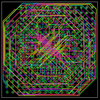

Reply 28 of 116, by elbbar
There may be an elegant symmetric routing for the surface mount version, but the shifted pin array version breaks it. One other advantage of the pin version is that the rotate left is the same board as the rotate right--just install the pins on the other side of the board.
I'm mostly just tinkering. I don't know the level of interest here, and the details depend on how it can be made. How much of a shift is actually needed for assembly? These guys might have some good ideas for actually making these adapters:
https://www.advanced.com/products/ic-socket-a … dapters/options
Sure a 12-layer board would be nice, but you can get 4-layer in small batches from places like oshpark. If that big stack of pin sockets will work, then a little rat's nest of traces might also. Here is a version that has wider traces and should meet oshpark's 4-layer design rules. I think the pin holes are 0.6mm, so it might depend on what size pins you'd want to install. Bigger holes take up room for wires...

Reply 29 of 116, by Sphere478
What happens if you only offset it 1.27 x 1.27y
This was my planned approach for a thru hole setup. Is it possible?
Yeah, my brain won’t be happy until I see something symetrical hahah 😂
Very nice work of course though. 😀

Reply 30 of 116, by feipoa
Are we sure the ground plane isn't necessary? The path lengths for the rotator board will have, perhaps, half the length of those from the unshielded prototype shown above and it was choking at low frequencies. There are, combined, 41 ground and Vcc pins. Wouldn't having Vcc and GND planes greatly reduce the quantity of traces needed? A 6-layer wouldn't be a show stopper, but 4 would be a lot more ideal. The through-hole approach is preferred so that anyone with the gerbers can assemble it with minimal soldering skills. On the other hand, elbbar is there a particular product you are recommending from Advance Interconnects which will allow simple assembly of 132 PGA pins via surface mount?

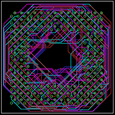

Reply 31 of 116, by elbbar
I shifted the pin version that way because it exposes most of the pins while keeping the board small. How would you build it if all the pins are covered? I don't know how I would do it, but it seems like there must be something to make it easier if surface mount is not desirable. I did see the solder preform idea. This would be similar to surface mount. Again, the details depend on how you plan to make it.
91.74 KiB
670 views
On the hand-made adapter, have you tried adding some bypass caps on the CPU socket? The power/ground pins are usually next to each other so you might be able to add little ceramic caps directly across pins on the CPU.

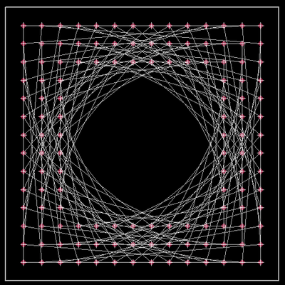

I think the 180 version would need more layers. This is a sort of worst case:
41.13 KiB
670 views

^at that pic, 😵💫

Reply 33 of 116, by elbbar

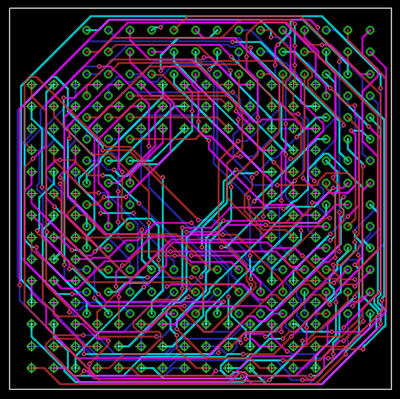

The 90 degree version can still route in 4 layers with a half-pin shift. If you wanted a ground plane you could make it as a 6 layer. Are the power and ground pins symmetric? Since you can plug the CPU in 4 different ways, it would be nice if it wouldn't fry when plugged in wrong.
72.03 KiB
647 views
The 180 degree version can route in 6 layers.

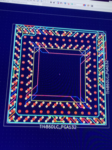

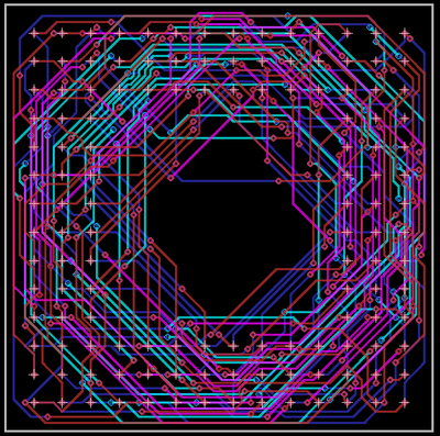

Here is the result of some tinkering I did.
So far so good. But more pins routed will tell the real tale of how doomed this attempt may be 🤣.
    1.69 MiB
    579 views

Reply 36 of 116, by Sphere478

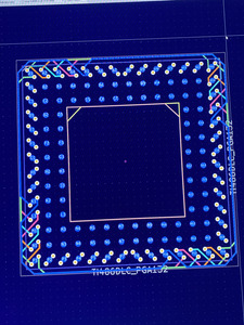

And more tinkering
    1.54 MiB
    570 views
Sphere's PCB projects.
