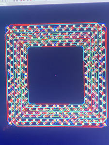

So let me remind that this is a non offset attempt. Smd design.
I’m coming up one pin short 🤣.
I’m starting with the outer layer of course because it is the hardest. But it is making it pretty apparent that doing it in a organized way is kinda hard. Here is my latest routing pattern. I have managed to route all but one. I think perhaps if I shift half of each side toward center I can make another ring on the outside to route the corners.

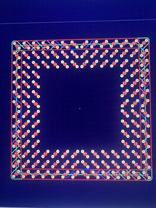

Reply 53 of 116, by Sphere478
Success!
Unfortunately this leaves a huge question mark for the middle ring. I don’t think there are is enough space left for middle with only two paths.

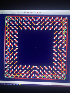

Reply 55 of 116, by Sphere478
Outer and middle row routed. Middle should be easy now.
6 layer, ‘in place’, SMD, 90*
2 stacked bga style for 180*?

Reply 57 of 116, by Sphere478
feipoa wrote on 2022-12-28, 14:40:
I won't be available much until the kids are back in school. […]
You were able to do +90 degrees as 6-layer? Your latest PM suggested 8-layer was required.
Can 180 degrees be done 8-layer, SMD both sides?
Worse case, you could always start increase the size of the PCB, perhaps starting with 1 mm all around.
Yes, I thought it wasn’t going to work, but I figured it out on pink layer. See the squiggly on pink?
Of course I could cheat and throw more vias everywhere, and make spaghetti but am trying to do it in a organized way.
This adapter is a clusterhump for signal interference btw.. The other approaches also, it looks like. So if it works at 80mhz that will be very interesting.
If we want to do something for that, we could go 10 or 12 layer and put ground planes between all layers. That would probably help. Then do bga stack for 180
It may be possible to route on less layers and fit ground planes between if we abandon the organized approach and throw more vias everywhere. But I still think that would be 8-10 layer at least and would look nasty 🤣
Idk, pros/cons.
But doing it this way (my way) it seems like 180 would take 12 layer at least. So the obvious solution is bga. This 90* is actually taking quite a bit of time to make. I’ve started over several times but seem to be on a roll with this latest one.
The nice thing is that the traces are almost equal length with this approach btw.

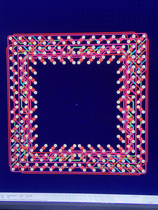

Reply 59 of 116, by Sphere478
Fully routed.
I gotta go back and make sure all the pins are rotating the same direction (easy fix so long as I catch it 🤣)
Then a few passes checking the trace routing for clearance/optimal paths. Also need to add ground layers. I think it would probably be a mistake not to have them.
