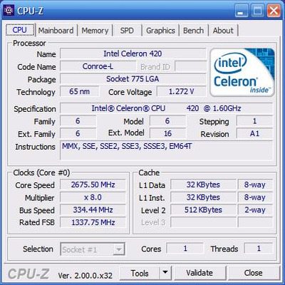

Reply 43 of 64, by pete8475
This Celeron is overclocking very well so far! 🤣
GTX770 - Celeron D 420 @ 2.67 - G31
3dmark01 - 31451
3dmark03 - 45488
3dmark05 - 11852
Aquamark3 - 96536
UT2003 1280x960
Flyby - 314.770233
Botmatch - 101.823257

Reply 44 of 64, by rasz_pl
looks like 1/3 IPC boost over P4, I expected better 😀 Celeron 420 should overclock all the way to 3GHz no sweat, 3.2GHz is the limit on normal air cooling.

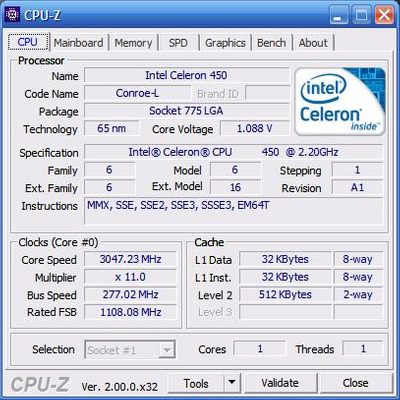

Reply 52 of 64, by pete8475
This is probably the last set of benchmarks. Overclocking any higher will result in a post but bluescreens during any heavy CPU usage.
GTX770 - Celeron D 450 @ 3.047 - G31 - 829.6mhz mem
3dmark01 - 33678
3dmark03 - 48599
3dmark05 - 12662
Aquamark3 - 103364
UT2003 1280x960
Flyby - 349.464813
Botmatch - 111.050087
If a motherboard with CPU voltage adjustment falls into my lap I'll revisit this but I am not ordering anything on ebay and putting a limit of $10-20 on any further kijiji/craigslist spending for this silly project.

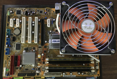

Reply 55 of 64, by pete8475
Breaking out the big guns to see what I can do with this P4 on this Asus board.
I was using this Big Typhoon cooler on an Athlon 64X2 but that board has some bad caps and has been retired for now.
