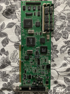

Hi,
I got a troublesome CT3620.
To make it come to life again, I reflowed all the QFP chips on it, and the X3 crystal wasn't producing any clock, until I desoldered L3. That's when I discovered L3 was cracked, so I bridged it with a piece of wire.
Also a handful of caps were damaged so I replaced them.
Starting from that, Soundblaster 16 portion of the card came back to life and I could listen to 8- and 16-Bit FM synthesis.
But when I run diagnose.exe from the soundblaster package, it recognizes everything and the full 8 megs this card can take test out fine, but won't play the EMU samples.
The RAM tests ok though, so something fishy is going on.
What I noticed is, that the CT1745A chip has a lot of bent pins, like it is mounted crooked on the pcb. Almost like the whole chip is turned 2-3 degrees clockwise, but there is no shorts between the pins. Only the 5th pad to the right on the lower edge of the chip seems to have lifted from the pcb, but I cant figure out if it is connected to anything, as there seem to be multiple pads that are not connected.
Also when I go ahead in windows and play a midi file, I can hear a very faint pop, suggesting the audio routing changes in the card, but then no sound is output from the card.
Another weird thing is, that I have to force windows to use the Soundblaster 16 / AWE32 PNP driver manually, if I don't it chooses a XPRESS audio driver for me (which does work but it seems wrong)
Any guesses what could be the culprit?
