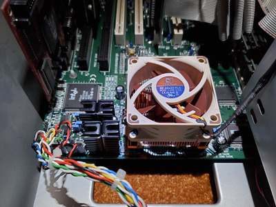

For CPU fans, I'd recommend replacing whatever stock fans you have with Noctua 60mm fans. Much quieter (virtually silent) in my experience.
I've got a couple builds (Athlon XP 2000+ and Pentium 133) where I use these fans and they work great (see pics).
As for the gpu coolers they don't demand anything else to be done in particular IMO. I was under the impression that speedfan didn't work in Win9x but will check it out.

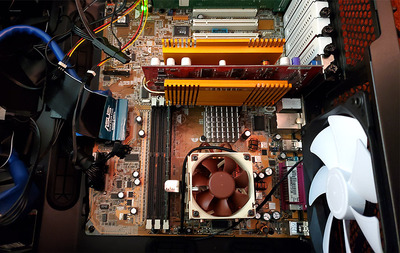

Are they putting out noise though?
For instance, I have a GeForce 4200 in my Athlon XP 2000+ build that was extremely noisy so I replaced the stock cooler with a fanless option.

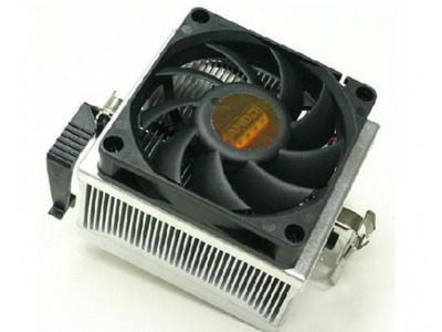

Just a normal stock AMD fan with its heatsink, the CPU's a Sempron actually, came built from the store at the time, looks pretty stock to me (see pic). Can't take some pics as the PC's are in some hard reaching places which is a problem for me in my current state, sorry. I do think I have an extra case fan or two, I'll try and find them to test them out when I'm able to in the future, thanks.

From what I'm reading from you guys/girls, if the 5v trick or using a 7v adapter is too binary of an option, I wouldn't mind to then just get a fan controller and run some benchmarks while keeping an eye on SpeedFan for temps and RPM so I can find the sweet spot, even if I end up decreasing only 15% or 20% for example. If it's just a question of finding the sweet spot then I'm willing to give it a go, as long as reducing the voltage just a notch isn't detrimental for these older fans regarding their lifespan for some reason.
I understand Noctua's advantages and I have seen from people's tweakings and projects that they are worth it, but for me in this particular instance I wouldn't need or even want silent or practically silent builds as like I said it detracts from the experience of using these older PCs. Adding to the fact that I would be playing games at a normal speaker volume, I would just need to bring the "case volume" down a notch to the point where it moves just a little further to background in relation to what I'm playing.
With my socket A 462 cooler/Tualatin combination I'm pretty sure it's running way above what would be needed, so I'm very confident I could decrease it to a nice level while keeping it cool, and as that's the worst example I have I would start there.

Reply 16 of 16, by andre_6
I ended up getting the Gelid fan controller at the time and was quite happy with it, even after finding the sweet spot between cooling performance and noise the difference was clear throughout my Win98SE/WinME/WinXP builds.
But I'd like to add the absolute biggest difference maker that I was ignoring at the time: Old vs. new PSUs. With the new PSUs in those 3 builds the noise was hugely reduced, and the fan controller almost wouldn't have been needed after removing the old PSUs. Specially the EuroTech PSU in my WinXP machine that was driving me crazy!
