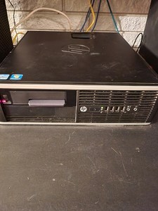

After much deliberation I've decided to go the small form factor route on a dedicated XP machine using the HP Elite 8200 SFF.
I'm currently working on some hardware upgrades for it and should wind up sort of like Phil's system here:
https://youtube.com/watch?v=C5QjZJvook8&feature=shares
If I get it locked down I may try dual boot Win XP\Win 7.
I'll keep this thread updated as I push along.

Well, here it is.... my new XP rig all set up.
Upgraded with an SSD, 4 GB RAM and a Radeon HD 7750.
Plays Far Cry on max settings smooth as silk.
Overall it is based on a rig I saw over on Phil's Computer Lab.
(Darn you Phil.... Stop giving me ideas to spend money on....)
