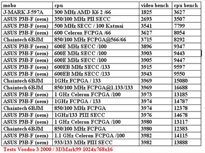

Tried looking at old benchmarks and I can't really find many that compare the 100fsb celeron's to PIII's. Perhaps by '01 when the 100fsb Celeron's were being released people had already moved on. I see that Phil did a 1ghz Celeron video but he only compared to PIII's that were half the speed.
In the past I ran a number of 3DMark 99 benchmarks that included the 1000 and 1100 Celerons. In general the 1000 Celeron scores a tiny bit better than a P3 850. But as stated above, it is possible that the larger cache of the P3 results in better scores in certain games. Depending on the videocard I would choose to run a P3 800 or 850 in order to not stress the VRM of the motherboard too much - those high end Celerons draw a lot of power. Here an overview that gives some impression:

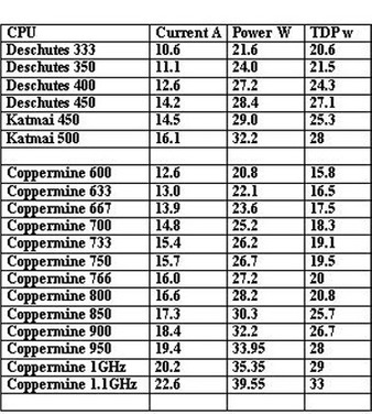

However, I took a look and the TDP on the Celeron 1ghz is 29W. For the 1ghz Pentium III it's 29W. as well .
They seem to be about the same Celeron vs Pentium III when comparing ghz and the Coppermine cores. How is the Celeron drawing more power and running hotter than its P III mhz equivalent?
the voltage that's printed on the CPU differs by sspec/stepping, and is the minimum voltage that the bios will let you set. afaik after that 1.13ghz fiasco, the steppings that intel put out are specified at 1.75v, at least down to the piii 700. so that one could be running at 1.65v or 1.75v depending on sspec...

Celerons are very energy inefficient for the performance they offer and given availability of PIII are a poor choice for anything else than testing unknown boards. They will run hotter because you need much higher frequency and TDP for the same performance. The performance penalty is huge at high multipliers. PIII 900E pays it as well but gets saved by cache. In 3d mark 99,2000,2001 PIII 900E is about as fast as PIII 840 (7.5x112) or PIII 800 (6x133).

Reply 13 of 35, by PARKE
_tk wrote on 2023-01-20, 23:04:
P3 and Celeron of the same frequency draw the same power.
The only reason I can see to use a high end Celeron instead of a P3 occurs when you cannot score a P3 that is powerful enough. And that also depends on the videocard that you use. For example: a Voodoo 3 runs at its maximum speed on a P3 with frequency of approximately 800 MHz and in such scenarios there is no need for a faster cpu.

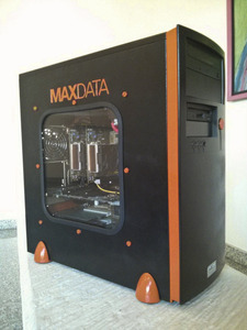

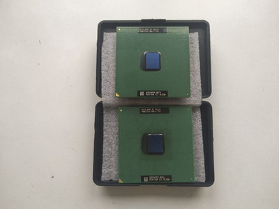

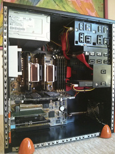

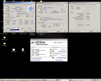

Due to following this thread, I couldn't help myself when I found a Coppermine P!!! 1100 on a Danish buy/sell page, maybe US$45 was a bit over the top, but on the bright side I now have 2 of them ... And an Asus P2B-DS: D
Reply 18 of 35, by MadYoshi
A Pentium III SL5QW - Coppermine - 1100/256/100/1,75V is the best native setup for ASUS P2B-DS. Congratulations!
