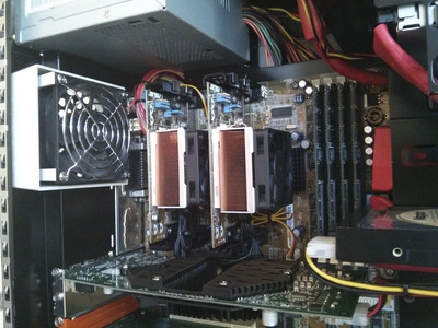

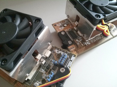

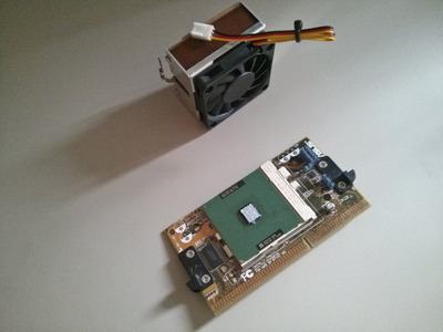

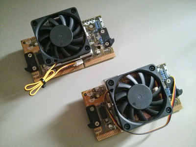

Reply 20 of 35, by MadYoshi
mrzmaster wrote on 2023-01-30, 22:42:
Very nice machine! What kind of slotket are you using?
ASUS S370-DL Rev. 1.02
294.89 KiB
1257 views
397.99 KiB
1257 views
297.62 KiB
1257 views
385.46 KiB
1257 views
Reply 21 of 35, by H3nrik V!
MadYoshi wrote on 2023-01-30, 21:18:
A Pentium III SL5QW - Coppermine - 1100/256/100/1,75V is the best native setup for ASUS P2B-DS. Congratulations! […]
OMG, those copper heatsinks are nice!
What revision P2B-DS are you running? It seems from Asus' homepage that at least rev. 1.06 is required for CuMine support, however mine, which is a 1.05 came with 2 667's, which I assume have been running (got it from a coworker, who'd been using it as a home server).
