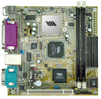

Does this look like your board?
EPIA_operating_guidelines1.pdf
3.94 MiB
48 downloads
478.03 KiB
454 views
Reply 2 of 4, by justin1985
PC Hoarder Patrol wrote on 2023-01-20, 22:47:
Yup that's the one - and that's an interesting document - different from the one I'd previously found online. It looks like that document describes a few more of the jumpers than the other manual.
I guess it might be worth trying other combinations of some of those? Like adjusting CPU host frequency? (To match memory module spec? Or just to minimum?)
Any idea what DOC BIOS might mean? Related to the Disk on Chip feature? (which is unpopulated on my board) Or something else?

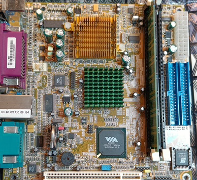

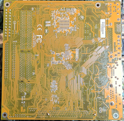

Think I see the listing in question, but maybe if you add a good rez pic of your board (front & back) someone might spot a component issue causing the no video / POST problem
Reply 4 of 4, by justin1985
PC Hoarder Patrol wrote on 2023-01-21, 18:14:
I think this is the best I'm going to be able to do in terms of photos of the board
1.49 MiB
337 views
VIA Epia 800 front
1.3 MiB
337 views
VIA Epia 800 back
I've studied the board pretty closely, and can't seem to see any obvious damaged or ripped off components. Unless the capacitors to the left of the gold CPU heatsink are actually looking swollen on top? I could equally believe the K shape in the top was just stamped a bit more heavily on these, rather than it being a problem? The back of the board does seem to feel like it has some kind of ... very slight residue ... or it just a protective lacquer or something? Worth a clean with IPA?
I've also reset all the jumpers to the default locations shown in the linked document above - they were all set in the opposite positions (someone had had a fiddle previously?). But still no joy.
I guess the other likely possibilities are a dead BIOS. Is it worth trying a replacement chip from here: https://biosmaster.co.uk ?
Otherwise, I imagine it's likely a key component like the CPU is fried? (which the missing CPU fan might make more likely?)
