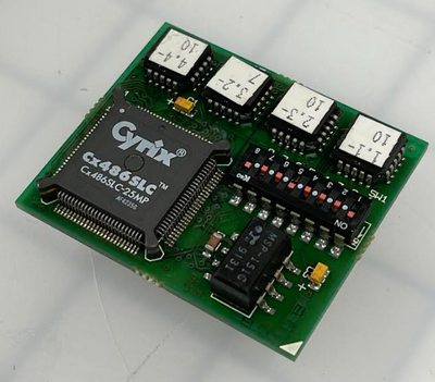

Hi, I have an IBM 5162 XT 286 and a Evergreen Superchip upgrade with the Cyrix 486SLC.
The manual for the Evergreen Superchip recommends to replace the bios with a "generic" AMI 80386 bios that they could have provided.
Does anyone know where I can find this bios, or a 386 bios that would work in my 5162? I have tried a few different bios's I have downloaded and flashed and none work completely. Either dont POST, don't save CMOS settings, or freeze during boot.

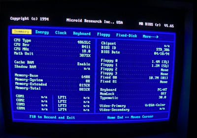

I recommend you use the MR-BIOS for generic 286 boards. I have one in my 5162, and I really like it.
Reply 2 of 3, by JonF
Thanks for the suggestion, I tried out the Mr Bios generic 386 and it worked!
Specifically "V000B300 STD_386 Generic 386" which is available in the Mr Bios zip file available on this site
http://vogonsdrivers.com/getfile.php?fileid=1971&menustate=0
