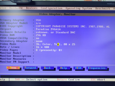

I have a strange noname 8bit vga card
https://ibb.co/dcHd194
All what i can find for it - that is from Olivetti computer and OEM.
Also on web i find that card possibly Prisma Graphics System VGA RT800.
I read bios from it, and in fisrs lines see "Olivetti" in dump.
https://drive.google.com/file/d/1m3KY5_ITE29v … ?usp=share_link
My problem is the standart utils for select video mode from WDC wont work with that card. Also i can't find anythig for this card - no jumper settings, manual, drivers or utils.
Maybe anyone who know Olivetti models line can help with identify it. I think need continue searching in OEM drivers for olivetti...
PS I find on Vogons old topic Re: WD90C11 and AT&T Model 6300 video mode as i know, for similar card. Try download and write bios but my card is won't show picture with it. Monitor on but out of range signal. (i have multisync with 30khz support)

That BIOS work ! YES !!! i write 32Kb file and got a picture !

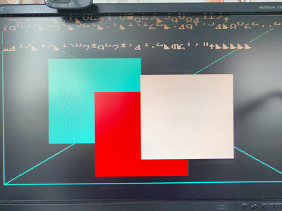

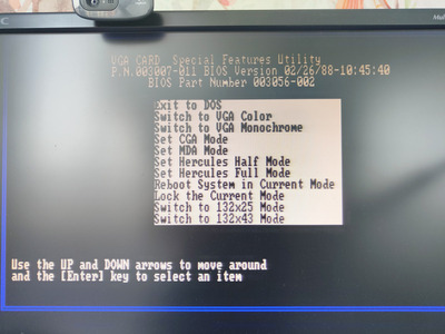

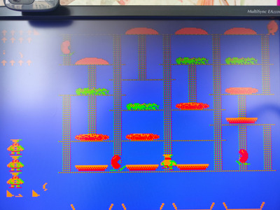

I try switch to CGA mode - screens are attached.

BIOS info

VGA util. Mode for select
1.62 MiB
982 views
CGA test brw palette with corrupted text
1.81 MiB

Burgertime right palette
That card have no EGA mode.
In CGA mode done with compatibility test, right palette but corrupted fonts.

Reply 13 of 14, by Jo22
Afaik, on a real CGA card running in graphics mode, the text font inside of the PC BIOS is used.
That's because the CGA text font stored in the EPROM on the CGA card is not accessible via PC/CPU.
So the PC BIOS must use its own "duplicate" of a CGA font (which isn't necessarily the same as the one on the CGA card).
On a VGA card, this might be different, not sure. Depends on the VGA BIOS: Whether or not it overrides the CGA graphics routines inside the PC BIOS.
That's possible, if the BIOS is copyied into RAM by the PC during boot (Shadow Memory).
Reply 14 of 14, by Ar2r4eg
Jo22 wrote on 2023-02-01, 17:14:
Afaik, on a real CGA card running in graphics mode, the text font inside of the PC BIOS is used. […]
Thank yot for answer. When test i use DOS 7.1 from Win98 setup. After i install clear MS-DOS 6.22 problem with fonts is gone !
