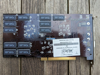

after i repaired my Voodoo 1 ( Re: Voodoo 1 repair - help ) with the help from you guys, I am again stuck.
I bought 2 Voodoo 2 over the years, but non of them work. So I took the better locking one without the obvious missing parts and startet to look at it.

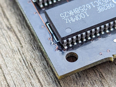

And i found a broken trace on the backside that i repaired.
617.43 KiB
234 views
But that did not help the card much. It was still not detected.

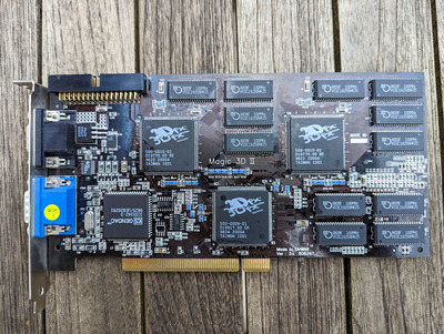

So I looked at the chips and resoldered all of the legs.
This is the card now:
1 MiB
234 views
843.2 KiB
234 views
