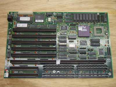

This is my kind of 386 board. Full-sized for no apparent reason. It's a nice shade of green too.
The SiS Rabbit chipset came in A/B/C revisions. I'm pretty sure this is a Rev A. I don't think those support more than 16MB memory or 128kb cache.
I have rev A rabbit board from CTI. It also only supports 1MB SIMMs...and I have been unsuccessful getting any replacement BIOSes working.
What kind of AMIBIOS does your board use? Is it the Color/Hi-Flex BIOS, or the earlier one from '89-'90? Mine uses an older AMI BIOS that is not very user friendly. It lets you adjust register bits, but it's kind of cryptic.
One other quirk with my board is that it only works with original 386s, not DLC type upgrades.

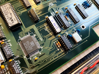

Good news, it seems I finally found the cause of the instability.
First i noticed that the "too low CPU frequency" problem kind of diminished during my troubleshooting. After a couple of hours or so everything seemed fine, the system would always start at the correct frequency. The next morning the same old issue was back again with a vengeance.
I also noticed that during starts that resulted in a 10.7 MHz CPU frequency, the tick-sound during memory count was faster and the POST beep sound had a higher pitch. So some oscillator frequency was different in these cases. Probably the frequency was too high and the system starts in some "fail safe" reduced frequency mode so BIOS setup can be entered.

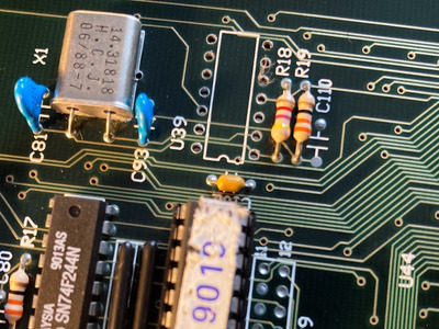

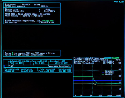

Because the issue occured when the system was cold I warmed single chips with a soldering iron before startup and ended up at a HEX-inverter that operates as a (ring-) osciillator (or two of them) with the 14. 31818 MHz crystal. When warm, the system would start at 33 MHz CPU frequency, when hot it would not start at all! So I removed the old "SN74F04N", fit a DIL14 socket in and populated it with a "SN74HC04N" - the only version I have on stock at the moment.

So far 100% of the starts have been successful, but this is going to be tested thoroughly.
