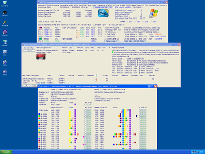

I am setting up a Windows NT V3.51 test system and trying to decide which GPU to use. At the moment I have a Radeon 9200 which has drivers for NT 4.00 through to Server 2003 x32, but I can't find an NT 3.51 driver for it so am limited to 800 x 600 x 16 colours which as you can see limits things.
file.php?id=156429
What is the newest GPU that has drivers for NT 3.51 through to Server 2003? In an ideal world I would also like Windows 7 x32 support, but suspect this is wishful thinking.

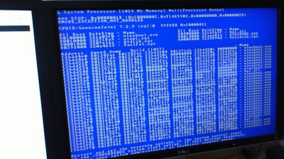

Thank you, I tried https://ftp.matrox.com/pub/mga/othermga/previ … us/1570_121.zip with my G400 installed as the only GPU. This resulted in a BSOD 🙁
file.php?id=156435
Which I feel is not ideal. I unplugged the G400, but still got the BSOB so deleted %SystemRoot%\System32\MGA.sys, then 3.51 booted 😀
Which driver did you use that worked rather than triggering a BSOD please?, a link to it would be good.

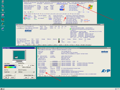

This one: https://www.matrox.com/en/video/apps/drivers/ … es/nt35_251.php (that page has a click-through to get to the actual driver).
Other G400 drivers for old OSs here: https://www.matrox.com/en/video/apps/drivers/ … perating_system
I don't have NT 3.5 installed at the moment, but I can fire it up over the weekend if it would help you.
Reply 6 of 9, by red-ray
lawyerpepper wrote on 2023-02-03, 19:22:
Thank you, that version is way better. I have set 1600 x 1200 x 32 as 1920 x 1200 only offers 24-bit colour. It's interesting that the G400 enables AGP when it's disabled in the 865PE chipset.
Do you know if dbghelp.dll and/or psapi.dll are available for NT3.51 please? I found them for NT4, but those won't load on 3.51.
file.php?id=156513
Which CPU would your NT 3.51 system have? Looking in HKLM\Hardware\Description\System\CentralProcessor\0 Identifier is x86 Family 7 Model 2 Stepping 9 when it should be Family 15 so I would be interested to see what you get.

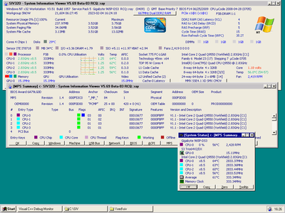

After a lot of fun and games I managed to install NT 3.51 on my Gigabyte 965P-DS3 which has 4GB of RAM. To get it to install I needed to drop it down to 2GB, but once I installed SP5 it's now happy with 4GB. So far it's reported 80586-A0 as the Identifier for all of Pentium 4 640 (Prescott 2M) + Pentium D 940 (Presler) + Celeron Dual E1400 (Allendale-512) + Core 2 Quad Q9550 (Yorkfield), so I guess anything post Northwood.
file.php?id=156593
I wonder if there are any PCIe GPUs with NT 3.51 drivers, I suspect not.

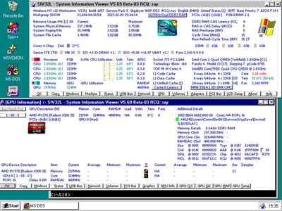

I felt I would like to have a PCIe GPU, but thus far can't find a working driver for NT 4.00 and I don't think an NT3.51 driver exists, does anyone know of one please?
For NT 4.00 I found DriverVer=05/20/2004, 4.00.03.4504, it installs, but when I reboot it get's half way through starting, then spontaneously reboots 🙁
file.php?id=156952
AFAIK the GPU is a X300 SE and the P/N is 102A6280100. It works great on 2003 which confirms it has 128MB
