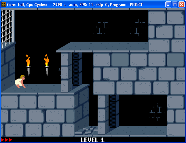

Thanks to a friend of mine (and Moe!) there's some things coming real soon...who can figure out what's "wrong" with this picture? 😁
    59.54 KiB
    1131 views
http://www.si-gamer.net/gulikoza

Reply 96 of 173, by `Moe`
It's actually more than hq2x. Think of it as an advanced variant that is based on the same general idea but improves in several details.
Reply 99 of 173, by gulikoza
I have it ready, but I need a few days to put all the other patches together (and wait some time for wd and qbix to commit their pending changes to the cvs 😉)
