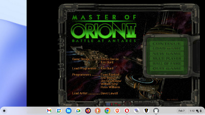

In SETTINGS I am set to LARGEST. LOOKS LIKE 1182x665
Master of Orion 2 ( actually looks like every game I try)
I cannot get the games to FULL SCREEN
The settings in this thread Dosbox scaling for resizing a SVGA 640x480x256 game improved things to about 50% of screen size.
I have given you the "RESOLUTION" I think but I have no idea how to determine the rest of this >> Video mode (Software, OpenGL, Direct3D, or Glide, and resolution)
---------------EDIT Ok I have now tried all of these settings and none made any change to the size of the screen.

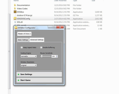

I just made a STUNNING discovery on my Win7Pro machine that I play games on.
In the Gog.com > MOO@ folder is a Configuration GUI.
Why isn't there such a thing for the Linux Build?
    72 KiB
    323 views
    63.7 KiB
    323 views
