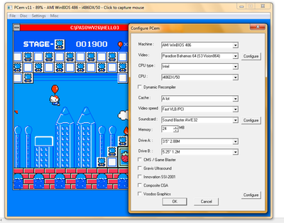

    Almost at full speed - Emulating a quick 486 on an Athlon 64 X2 (2016)

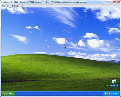

Hi there! I think it's possible to run XP itself just fine in emulation per se.
It can run on about the same hardware as Windows 98SE, after all;
they were released two years apart, merely.
In fact, there's a screenshot of XP on the official homepage (attached) from long ago (v10)..
That's a bit older than my first XP machine, even (Pentium MMX 166 was the official minimum requirement).

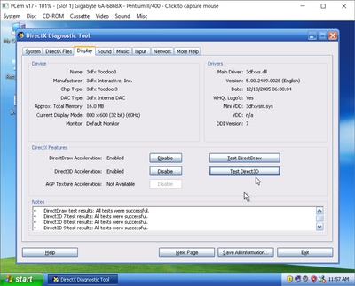

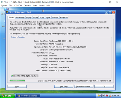

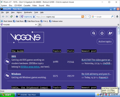

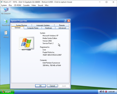

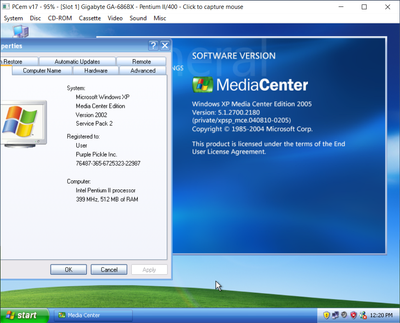

Reply 7 of 11, by Norton Commander
XP is doable in PCEM but not recommended for optimal experience.
Here is how I setup PCEM 17 to run XP:
512 MB
3DFX Voodoo 3 3000
Fast VLB/PCI
Voodoo Graphics box ticked
Ensoniq AudioPCI (ES1371)
Standard IDE
Network card: RTL8029AS
423.31 KiB
2472 views
Performance is not great.

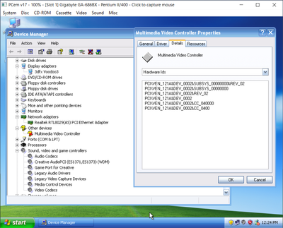

Dxdiag successfully completes all DirectDraw/Direct3D/Directsound tests.
230.14 KiB
2472 views
225.61 KiB
2472 views
Oops captured mouse cursor from VM and host 😜
Only one unknown device in device manager, I have it disabled because it kept prompting for drivers with every reboot.
273.57 KiB
2472 views
Your choice of web browsers will be limited to those that don't require SSE2 so PaleMoon or Opera 12.x variants.
184.57 KiB
2472 views
Network speed is currently limited to 10Mb/s but the fastest download speeds I could get were about 80KB/s. Forget Youtube or other video sites, they stutter horribly.
The only games I recommend running are the ones included with XP (Solitaire, Space Cadet Pinball, Minesweeper etc.). I tried running WinVice emulator and got max 17FPS.
For XP gaming your best bet is a rig that will run XP natively although that's getting more difficult due to the lack of driver support. A virtualizer with hardware acceleration support is something I always suggest because you will get the best gaming performance depending on the host PC specs.
This was just an experment to test the PCEM's limitations. Advantages? No installation required, portable, can be run from USB flash drive.

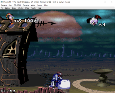

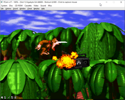

Reply 8 of 11, by Jo22
^Cool, thanks for testing! 😎👍
I see that the emulation is a Pentium II @400 Mhz.
Back in early 2000, I didn't dare to dream about that, despite that Pentium III 733 MHz being in the house.
Personally, I had a humble Pentium 166 MMX PC with 64 MB RAM and a SCSI HDD.
It was running 98SE, but it had issues with all sorts of emulators. So I installed Windows XP SP0 or SP1, not sure. And that fixed it.
The system crawled, but not the applications. They ran as good as on Windows 98SE, if not better.
Since you mentioned WinVice.. I have fond memories of running SNES9x on that Pentium MMX 166 w/ XP.
Frame skip was on auto, I believe. Still, Tiny Toons Adventures ran smoothly. It was really fun, thanks to XP.
Btw, the memory settings aren't ideal. Please try 768 MB instead of 512 MB.
SP2 is a bit memory hungry and needs more RAM than early XP to run smoothly.
PCEM limits the amount you can set to 512MB - fortunately you can manually edit the VM's CFG file to bypass this limit. Look for the value mem_size and modify it (value is in bytes). I tried setting it to 1 GB but the virtual machine wouldn't even start so I set it to 768 MB and it worked.

I fired up SNES9W and was impressed that it was playable (I have the FPS turned on in the lower left corner).
244.88 KiB
2348 views
Donkey Kong Country
234.01 KiB
2348 views
EarthWorm Jim
So looks like you can run old school console emulators in XP/PCEM. I haven't tried any 3D FPS types but I doubt they would be playable.
Maybe when I have more time I'll try some other games and post results. Still, very cool that XP can run somewhat smoothly in PCEM. I like to fire it up just to watch the XP 3D screensaver.

Microsoft has purged all XP downloads from its site but somehow this one was overlooked.
http://download.microsoft.com/download/whistl … 3DwindowsXP.exe
I tried everything to get this running on other Windows versions but it only works in XP. Maybe some of you more experienced hackers can figure it out.
