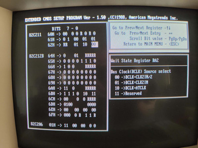

Reply 35 of 53, by elvovirto
This was the closest thing I could find in the CMOS setup to clocking.
I tried changing it to all the available values (other than reserved) and the system will have graphical errors with or without the CF reader installed and at either 8 or 16Mhz.

Reply 36 of 53, by pentiumspeed
elvovirto wrote on 2023-02-21, 20:22:
Hi
This is too early motherboard, this was exactly like that, what I had back in the day, all white text CMOS settings, C&T (CHIPS) and 386DX 25. No matter what I tweak the settings to speed up, board crashes so I left it to defaults plus C&T chipset is very slow chipset, and not made for speed.
Stick to using 512MB or less CF and set the hard drive type to 504MB, then fdisk and delete all partitions, recreate the partitions and finish the rest.

Reply 37 of 53, by elvovirto
pentiumspeed wrote on 2023-02-21, 20:28:
Hi […]
Hi
Cheers,
Card size is not my concern. It currently has a 2Gb CF card in the reader from another system that was already configured with OnTrack. DOS sees all 2Gb regardless of what the CMOS settings are.
Here are my actual issues:
If you use this CF reader, you are UNABLE to run the system at 16Mhz. It works fine at 8Mhz - otherwise the display is garbled.
If you use my spare CF reader, which lives full-time in my P120, the system won't even POST.
If you use the SD adapter I bought specifically to try on this system, there are no display issues at 8 or 16Mhz. You can FDISK/Format/etc but once you try to read from the device, it craps itself. DOS 6.21 cannot complete an install, and if you SYS the device, it cannot boot from it. If you attempt to use OnTrack, it fails with an unrecoverable IO error. EzDrive stack overflows. This occurs regardless of the brand or size of card installed.
I have ordered one additional type of CF adapter that will connect directly to the IDE header pins on the controller card without using a cable.
