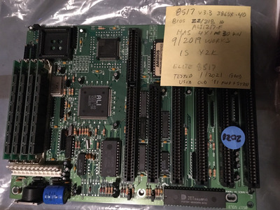

Reply 7 of 7, by Horun
The Serpent Rider wrote on 2023-02-17, 13:47:
So apparently these don't leak if no charge is applied, based on my sample size of one.
I have a few boards with pristine looking batteries. That condition never changed after few years of laying around in my possession. So yeah, no charge = no destructive chemical reaction.
Me too ! I have one that still looks like new and works (holds a charge) from 1994 <I never replaced it>. I do keep an eye on it though it being one of 70+ in my collection and only a 386SX-40 am not too worried ;p
