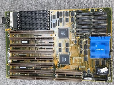

I recently acquired this FIC 486 VE-V motherboard, without its BIOS. It physically appears to be in nice shape; nothing is really per se wrong with it except for the missing BIOS. Attached is a photo from the seller. Does anyone here have one of these?

The crystal oscillator is missing, too 😉

Good catch! I keep a bunch on hand, so I put a few aside. I’m looking to see if this board can do 40MHz+ FSB, ideally even 50MHz or 60/66MHz.

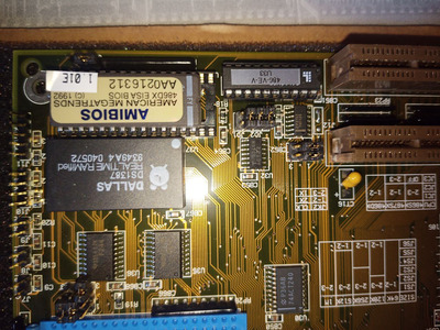

I have here a FIC 486VE, it is really NOS, never in use.
I take soon him...and dump ROM

Pleas click on this URL , i have attached ROM dump
