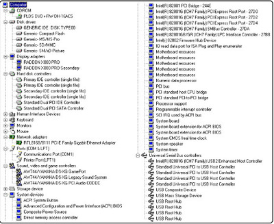

Reply 3 of 4, by bmwsvsu
Not that exact motherboard - but I've successfully installed Windows 98 on a motherboard with a G41/ICH7 combination with 100% compatibility and with no problems in the device manager (upon installing a PCI sound card, PCIe video card, and PCI ethernet card and disabling all the onboard options for those 3 items). Here's a screenshot. This is using an OEM Lenovo 775 board with ICH7 chipset. There are modified chipset drivers out there that you will need to download.
