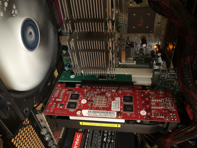

Hello all.
I was trying to find a dual S370 card with PCI-X slots that would work with vga in it.
The Supermicro 370DLE worked well.
I paired it with two LinLin adapters to accommodate two SL5XL P-3s 1.4Ghz.
The only problem is that they are both stuck at 1.6V no matter what setting I use on adapters (the VRM can go low to 1.4v).
Used a PCI 32bit to PCIe x16 adapter and a GTS 450 low profile.
I used this card because it has external power connector while still be low profile. This avoid the limitations of pci slot power delivery.
It works, rock solid, although I am limited to 266MB.
Would like to find a PCI-X 64bit to pcie adapter but it seems it is impossible.

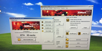

The performances are not so great, 6K on 3dmark2001, because of bandwidth??
What is strange is that I launched a 1080p movie (Mediaplayer classic!HC 1.7.1) and I obtain 10ths at best, with cpu usage around 30%…. Am I missing something here?
Maybe drivers are not so great?
Full specs:
-SM 370DLE last bios
-2gb pc133 reg ecc
-2X LinLin/ 2X Pentium III-S 1400Mhz
-Noname pci 32bit 66Mhz-Pcie 16x adapter + GTS 450 LP
-Promise SATA2 card+Samsung 830 120gb ssd
-X-Fi gamer
-NEC usb card
-WinXP SP3

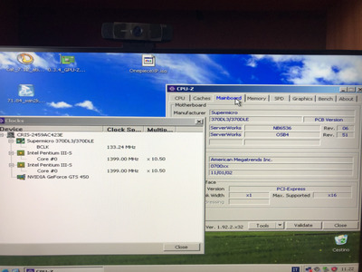

Maybe my adapter is not really working at 66Mhz? Seeing the results of last link make me think this.
How can I check?
Reply 5 of 29, by cyclone3d
What plx is the adapter using. Looking at the spec sheet will tell you if it supports 66Mhz or not.
Is there a setting in BIOS that lets you set the speed of the PCI slots?

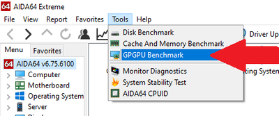

The easiest way to check the actual bus bandwidth is to use Aida64 GPGPU benchmark. To be specific, the "memory read" and "memory write". With regular 32bit, 33 MHz PCI I got 110-120 MB/s. So if you are running at 66 MHz, you can expect > 200 MB/s.
Just a note - you need to have properly working OpenCL. That shouldn't be a problem with GTS 450.

Reply 17 of 29, by agent_x007
Mamba wrote on 2023-02-25, 16:38:
Unfortunately I am not able to see any gpgpu benchmark option in AIDA64….
Big red arrow should help :
13.45 KiB
754 views

I dont know about that adapter but for that board to run the PCI-X slots at 66 MHz jumper pins JP13 must be open and from your attached picture it appears to be jumpered closed.
