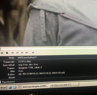

Reply 24 of 29, by havli
I don't know about plain MPC, but MPC HC definitely can use h264 HW decoder if the GPU supports it. If DXVA is active, it shows "Playing [H/W]" in the bottom left corner of the window. When only SW decoding is present, the "[H/W]" is missing. Also you can see some statistics by pressing CTRL+J. Like on the screenshot below.
By the way, this is version 1.7.5 I found on my HDD - should be old enough to run even on PIII. If you can't find it, let me know, I'll upload it somewhere.

Yes,
I have mpc hc 1.7.1
It shows DXVA in bottom left corner, but nothing about sw or hw.
Also, I did not installed any codec pack.
Should I?
Reply 26 of 29, by havli
And what does it report when you press the CTRL+J?
MPC HC has all the needed codecs built-in. No need to install anything else.

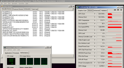

Reply 27 of 29, by bakemono
Check your video engine load under GPU-Z to see if the hardware decode is working. Maybe also have a look at DXVA Checker.
(BTW, it was somewhat mind boggling when I hit ctrl+printscrn and pasted the screenshot into irfanview and then the video appeared to continue playing inside the screenshot in the irfanview window...)

Reply 28 of 29, by Mamba
I am still trying to understand why only drivers 67.66 let the fx5200 card work at 66Mhz bus.
All the others force it at 33mhz….
Reverted back to 67.66, it is the only one the lets the card work fine. The reason why it happens is beyond me….
CPU is at 100%
No hardware acceleration of any kind, make sense as fx5200 has no h264 support.
Right?
Still it is far better then the GTS+bridge, with 33% of cpu utilisation.
This negate most of previous statements on crippling bandwith.
The problem was somewhere else.
