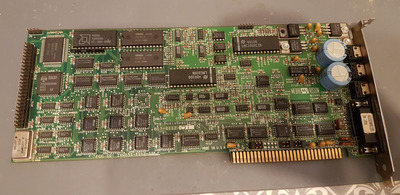

As this soundcard is quite rare then would like put effort to resurrect it to the life.
Two issues:
1) Missing GAL
2) VCC/GND short.
So firstly I have to find broken IC which causes short. Not capacitors as I already lifted them.
Any ideas which ICs should desoldery firstly ?
    1.59 MiB
    462 views
Reply 1 of 5, by bogdanpaulb
Lots of tantalums / maybe one of them first . Also don't see buck converters so i think you can take the minimum voltage ( see the ic's data sheets) an inject that voltage (high current) ..see what gets hot. Saves allot of time with soldering/desoldering/soldering again . If you are not a fan of that you can use a ohmmeter to approximate the location of the short on the pcb , thou in this case i think injecting is the fastest way to go.

added: Sorry your picture is not very clear but I do see a missing bolt/nut on the one LM317, it should be bolted down. Also J1 should be changed to third jumper IRQ5, is currently on 7. I cannot see any shorts.
