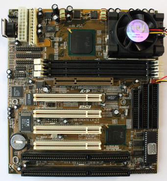

This board is pretty compact and full-featured, including an AGP 2x slot, Creative Labs 3D ViBRA16X SB16 (CT2511-SBT chip with latest DSP 4.16 and CQM), 4 PCI slots and 2 ISA slots.
Out of the box it only supports Mendocino Celeron CPUs.
But anyway I tried Coppermines. None worked but to my surprise, only one did. The Celeron Coppermine 566MHz. Perhaps for this (the first Celeron Coppermine?) they kept some compatibility with the Mendocino wiring.
I was pretty happy about this fact and ended up overclocking it without problems to 714MHz (83.3MHz bus). SSE instructions and 714MHz, not bad for a 440LX, right?

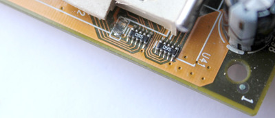

There's still the limitation about 83MHz being the max bus speed, and that probably induces some instability with the rest of the devices but I'm not sure about that.
Later, I performed the right mod and was able to run all Coppermines flawlessly. The fastest one I own, a 1100MHz Pentium III, runs at 916MHz and that's probably as fast as possible with the current BIOS.

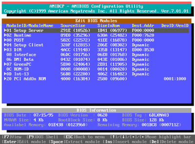

I tried a modded Tualatin and... it also worked! But the problem is that the L1/L2 cache is not working (the same happens with a VIA C3 processor), presumably because it lacks the correct microcode. Cache is detected as 256KB on the POST screen, and although it's enabled in the BIOS configuration, it also prints "disabled" next to 256KB. I also tried enabling it with SETMUL to no avail.
I tried to mod the BIOS using AMIBCP v7.01.01 and v7.60.04 as well as older versions such as v6.24 but I don't think those are more useful. In 7.01.01 I go to 'Edit BIOS Modules' but no 'P6 Micro Code' is there. So I don't know how to proceed. Does anybody know if I need a specific version of AMIBCP or maybe a different software? Should I change a register? Which one? Any guidance would be greatly appreciated.

Some info I took from the BIOS file:
CTLX110E.ROM.zip
116.56 KiB
40 downloads
BIOS Type: AMI PCI PnP (07/15/95)
BIOS Version: 1.10 (990404)
DMI Info: Zida Tech. 6DLX 1.01
BIOS String: 61-A03-8001000-00111111-071595-i440LX$6DLXNA03CreateLX-CT Ver 1.10 (990404)

I don't know which way it's better to go, to mod the v1.09 to add Coppermine (and Tualatin) compatibility or to mod the v1.10 to fix the AGP incompatibility. Probably the easiest is to add the correct microcode to the v1.09, but will this break AGP compatibility...?
As I mentioned in my first post, I don't know how to extract the microcode from either of these BIOSes, as they don't seem to be fully compatible with AMIBCP 6.24 / 7.01.01 / 7.60.04 as the P6 Microcode item is not listed and I don't know about other software to mod the BIOS.
Can anybody help me with this? It should be straightforward, shouldn't it?
Using AMIBCP 6.24, both BIOS versions have the same values in "INTEL PIIIX4 BootBlock Table".
AMIBCP 7.01.01 doesn't let you edit the Register Table (it appears as empty).
Inside the option "Edit PCI IRQ Routing Table", both BIOS versions look the same.
There are a few modules that can be erased/modified. I don't think this is the right thing to mod but I tried it anyway:
1st mod
I took the PCI module from the 1.09 bios and inserted it at the same location with the same identifier in the 1.10 bios file. L2 works, but I get the same blank screen upon booting an OS (no change).
2nd mod
Adding the DMI module from 1.10 bios to the 1.09 bios. The L2 cache still doesn't work (no change).
Something to note is that whenever you try to use a Coppermine on the 1.09 you get this message:
"USB Device(s): Keyboard Mouse Hub Floppy Unknown"
It also appears when you try to use a Tualatin on 1.10.
That immidiately gives you a hint, the L2 cache is not going to work...
Also, inside the BIOS menu, the L2 cache is marked as "WriteThrough" instead of "WriteBack" and that also is a hint that the L2 is not going to work.
So I'm completely out of ideas. The good part is that I know it's something doable/fixable but I'm not knowledgeable enough to mod it.

Reply 17 of 26, by tauro
I was trying bigger fans very gently but somehow I destroyed a capacitor...
I can replace it but I don't know what value it should be.
Can anybody please tell me approximate values and where I could find them? 🙏
I have a few scrape socket 370 boards and others.
    141.4 KiB
    1084 views
    138.64 KiB
    1084 views
Reply 18 of 26, by AlexZ
rasz_pl wrote on 2023-02-28, 05:25:
Zeerex wrote on 2023-02-28, 04:35:
Is this a known thing, about Coppermine 566 processors being compatible with PPGA socket 370?
not that Im aware of
Yes it's a known thing. They are PPGA, not FCPGA. I have a Coppermine Celeron 566 and it works in PPGA adapters while the rest of Celerons do not. They are the best choice for unmodded PPGA 440LX boards as they will be stable at 710Mhz for sure (8.5 x 83.3). At that speed they should be equivalent to PIII 600 Katmai.
Pentium III 900E, ECS P6BXT-A+, 384MB RAM, NVIDIA GeForce FX 5600 128MB, Voodoo 2 12MB, 80GB HDD, Yamaha SM718 ISA, 19" AOC 9GlrA
Athlon 64 3400+, MSI K8T Neo V, 1GB RAM, NVIDIA GeForce 7600GT 512MB, 250GB HDD, Sound Blaster Audigy 2 ZS
Reply 19 of 26, by tauro
I removed and measured the cap on the left, it's 0.1µF. So I put another 0.1µF in place of the missing one and... sad news.
Mendocinos give me a 00 error on the POST card, that is to say, they don't even post.
Coppermines get further, they initialize, they check the memory and video but then they halt with a 01 error. No POST.
The only one that still works is the 566MHz Coppermine Celeron!
My suspicion is that I didn't break the capacitor right now, it was probably missing/broken long ago, but I only noticed it now because I started having these problems. I suspect that I broke something else, the question is, what? I couldn't find any damaged traces. I only tried a couple of heatsinks that didn't fit and I did it gently.
I removed the mod but it didn't help, Mendocinos still fail to POST with error 00.
Just when I was about to settle with a Mendocino and put everything in a case... this happens... too much. Sad turn of events. Frustration. The fact that the Coppermine 566MHz still works adds more mystery to the problem.
If you have any ideas about what to measure/replace/do, please share them.
