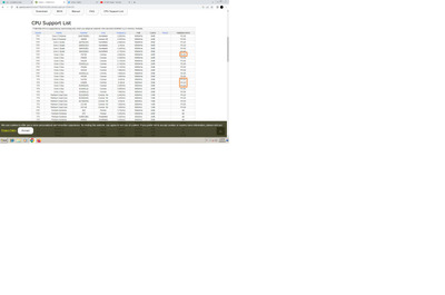

The AsRock board has the Intel 865 chipset which if the board is ok (has dual channel support also) , should be rock solid and outperform the p4m800 . The only main advantage of the via chipset it's the ability to work with the pci ESS sound card in real dos so you can have a decent sound blaster sound/compatibility ( the south bridge from the AsRock board does not allow that ). If your aim is win 98 only , the E6700 will work fine with the AsRock one , if you have decent ram modules . If you look at the cpu support list the E6700 was validated on that board on a bios version older then the top E4X00 were . And also let's consider the scenario that you have crappy ram modules , you can still use the E6700 with a 800 FSB until you find better ram .
