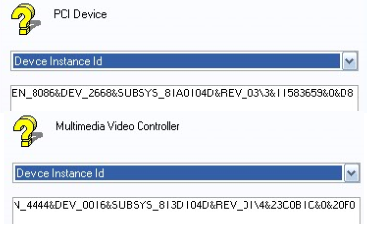

Problem was that the drive was dead. It came with Windows XP Media Center 2005
I've got a copy of Windows XP Media Center 2005 and I've got all of the drivers on it except for the modem and the Video Capture Card.
44.32 KiB
269 views
Sony says they don't have the rights for the drivers any more, if I read the website correctly.
Nothing on https://rebyte.me
Maybe if I could find the name of the files I could find it on http://dose.0wnz.at/ftp.vaiolink.com/PUB/VAIO/
Any suggestions?

For the latter, this might be it? https://driverpack.io/en/hwids/PCI%5CVEN_4444%26DEV_0016

There's also this link which seems to have both modem & multimedia video controller (see attached .inf text) drivers for XP - https://www.driverscape.com/manufacturers/son … 0g%28uc%29/5869

Yeah the Video controller driver matches with Python2 MPEG2 CAP: %smrt.DeviceDesc%=smrt.Device,PCI\VEN_4444&DEV_0016&SUBSYS_813D104D
but the modem driver ID does not match the ID in picture.... poor google of PCI\VEN8086&dev_2668 comes up as HD audio so maybe it is it
