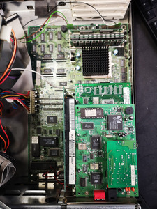

Hi there all:-)
ik got here a "Fujitsu icl indiana" a want to reset the bios but i can't find the bios battery on the motherboard, maybe I'm looking over it but there should be a bios battery on it, right?
thanks in advance, Marcel

There are jumpers near the Dallas RTC , but the img is to blurry to be able to read the description .

I believe this is your motherboard:
https://theretroweb.com/motherboards/s/icl-indiana-d-series
You can find the jumper settings under download. I am guessing you want to try to short pin 2-3 on JP2 to disable the password.
If that doesn't work you need to flash a new bios, but try the jumpers first.

I'm gonna look into this, thanks!
