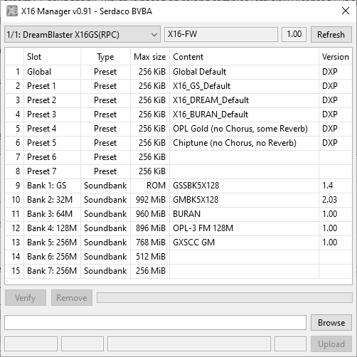

X16 is now launched, pre-orders are shipping.
The default banks and presets are finalized :
11.43 KiB
2394 views
For X16GS :
Bank1 : Dream/Roland GS Bank (officially licensed, ROM bank - not updateable)
Bank2 : Dream Cleanwave Bank (official)
Bank3 : Buran Bank
Bank4: OPL3-FM General MIDI bank
Bank5: GXSCC Chiptune bank
For X16: (the version without GS bank)
Bank1 : Dream Cleanwave Bank (official)
Bank2 : Dream Cleanwave Bank (official) (different preset applied)
Bank3 : Buran Bank
Thanks for your support !
