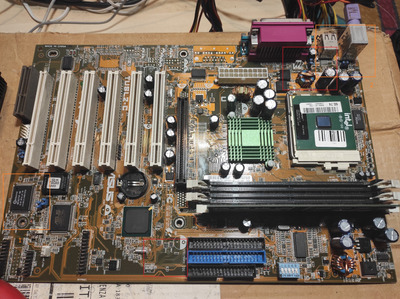

Asus board went nuts
Reply 40 of 82, by Nemo1985
ediflorianUS wrote on 2023-03-06, 15:00:
did not read all , but did you change keyboard? seems a kb issue or at least kb input issue somewhere on the line of KB....
Problems are also without keyboard connected so actually it doesn't matter I fear.
rasz_pl wrote on 2023-03-06, 14:16:
all behind the coil […]
Nemo1985 wrote on 2023-03-06, 12:49:
That's a point, which caps? The one near the coil wire?
all behind the coil
Measure... i'm sorry but about it i'm quite dumb, can you show me where I have to use the tips of the meter?
https://en.wikipedia.org/wiki/PS/2_port
pins 1 3 4 5
also pins 1 5 all the way to superIO chip pins
Ok continuity mode it beeps on pins 3, it should be ok.
Resistance resistance between pin 4 and ground is 0.535 fixed value.
Resistance resistance between pin 1 and ground is 1.4xx and increase, same goes for pin 5.
About continuity between super io chip pins and pin 1 or 5, I got no beeps. So no continuity
TrashPanda wrote on 2023-03-06, 14:35:
bogdanpaulb wrote on 2023-03-06, 14:25:
Might be the pic , but that trace looks interrupted by corrosion .
They certainly dont look right and since they look like they are going to and from the IDE sockets they might be worth checking for continuity.
Those traces are not in good conditions but to a first glance they are connected to the secondary ide port. If I connect an hard drive to the primary port it gets recognized right from the bios.
I took another picture, it doesn't seem cut but some corrosion is going here?
1.24 MiB
519 views

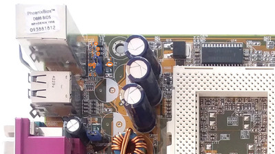

Reply 51 of 82, by bogdanpaulb
Again , can you make a focused pic of that area ? That pin of the resistor pack is not shiny like the rest , that might be corrosion , that trace might also be eaten by corrosion . Can't tell that if the pic is out of focus .
    666.39 KiB
    412 views

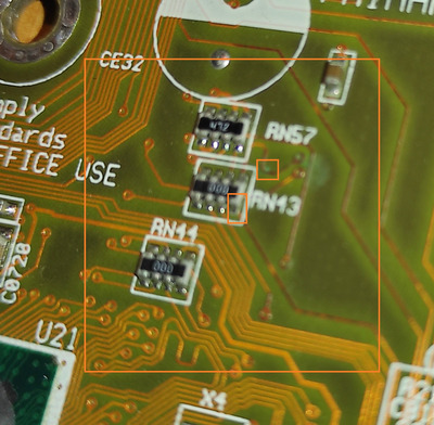

Reply 52 of 82, by Nemo1985
bogdanpaulb wrote on 2023-03-07, 04:46:
I hope those are ok, that's the best my cellphone camera can do:
https://imgur.com/a/kevcfH2
Reply 53 of 82, by bogdanpaulb
That looks ok.
Can you cofirm 5V when system is ON for both '1' positions ?
Can you measure '2'3'4'5' ('5' is next to '4' and not the jumper) relative to ground (metal shield of the kb conn) in diode mode(continuity) and specify me the values for both cases when you have 'red ' to ground and 'black' to ground ? ( System OFF , no PSU connected to the board ) .
    247.28 KiB
    387 views

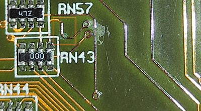

Reply 57 of 82, by bogdanpaulb
Use a heater(hair drier) on the area where you used ipa . (5~ minutes).
Do you have a soldering iron / any soldering skills ?
Black to ground - you should have nothing ( 1 on the screen same as the leads are not connected to anything ).
Red to ground - ~700 , same value on all 4 ( a few seconds for the value to settle should be enough )
Nemo1985 wrote on 2023-03-07, 07:08:
Black to ground: 2: v0,993 3: goes up to v1.9xx and slowly increase 4: went up to v1.812 5: v0.97x slowly decrease […]
Black to ground:
2: v0,993
Red to ground:
2: begins from 0,6xx and slowly decrease
3: v0.7xx and slowly decrease
4: v0.753
5: v0.65x and slowly decrease
This tells me that you have unwanted resistance to ground ( i hope that when you took the measurements you removed the PSU and the KEYBOARD/MOUSE ) most likely due to corrosion (could be a bad super i/o but let's try to eliminate the corrosion factor first ).
I need a perpendicular clear/focused pic of area 1 and a perpendicular and angled clear/focused pic of area 2 (remove the jumper for the pic).
Also that trace looks bad and has to be addressed.
    1.97 MiB
    330 views
    355.82 KiB
    330 views

Reply 59 of 82, by bogdanpaulb
Area 1 is the super i/o chip near the bottom next to the last pci connector , 2 is with the ps2 ports .
You can leave the trace but that one looks bad and i had cases of the protective layer being above cooper that was already eaten by corrosion . You can scrape it on the surface with a sharp tool just to be sure that you still have cooper underneath. And if it checks out use a protective lacquer / nail polish / whatever you have at hand and does not react with cooper .
