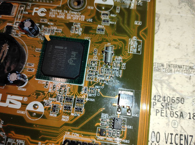

Reply 61 of 82, by Nemo1985
bogdanpaulb wrote on 2023-03-07, 09:51:
Area 1 is the super i/o chip near the bottom next to the last pci connector , 2 is with the ps2 ports .
You can leave the trace but that one looks bad and i had cases of the protective layer being above cooper that was already eaten by corrosion . You can scrape it on the surface with a sharp tool just to be sure that you still have cooper underneath. And if it checks out use a protective lacquer / nail polish / whatever you have at hand and does not react with cooper .
Pictures as per your request, I hope those are satisfactory:
https://imgur.com/a/KB730c4
I do not have nail polish or whatever, just acetone, ipa and lithium grease.
ediflorianUS wrote on 2023-03-07, 09:52:
BTW , nice hdd on the floor :D […]
BTW , nice hdd on the floor 😁
Can you bridge the power button pins? see if it starts? don't reflow with hair drier , not worth the risk.
did you try manual fsb+volt setting ? see manual http://dlcdnet.asus.com/pub/ASUS/mb/sock370/8 … /tusl2c-104.pdf
did you reposition the CPU? clear the cmos? (with no cpu in) , plug new 3v bat?
did you clean with contact cleaner or acetone the traces in photo? did you check the continuity of the traces?
I can do that but if there is a short it will blow up something...
I didn't try the manual fsb+volt settings because motherboard didn't start anymore
Reposition and switch cpu and ram was tried before open the topic. Clear cmos is not possible since the jumper is missing but without the lithium battery it gets cleared easily.
I cleaned the traces with ipa, no alcoohol if there is a corrosion that goes on it should be wise to understand if it is acid or basic, I doubt acetone will be of any use?

Nemo1985 wrote on 2023-03-07, 01:49:
Resistance resistance between pin 4 and ground is 0.535 fixed value.
Resistance pin4 to ground: https://youtu.be/7QS1SPjUz9o
we went from short to 1.5Kohm 😀
Continuity between pin 1 and i\o (in this video I also show you the beep of when proper continuity is present): https://www.youtube.com/watch?v=smFxTRuoAFY
Continuity between pin 5 and i\o: https://youtu.be/y6s1i2hytz0
sadly looks right, all keyboard/mouse signals go thru 68ohm resistor pack + 4.7Kohm pullup
Nemo1985 wrote on 2023-03-07, 06:35:
I would gladly do but apparently the motherboard doesn't turn on now...
problem solved itself ;o] but seriously, I think liquid damage might be the main cause of this board slowly dying on you. Your measuring skills and lack of soldering skills might be the end of this board journey, but you could probably still recover some $ selling it "for parts/not working"
bogdanpaulb wrote on 2023-03-07, 06:39:
Then can you do this ? 'Can you measure '2'3'4'5'
on ps2 port? why pin 2?
('5' is next to '4' and not the jumper)

Reply 65 of 82, by Nemo1985
Ok so I shorted the 2 gnd with the green cable, made the motherboard turns on, nothing blew up but that being said now the debug card show the infamous ---- code.
The psu turns off as soon I remove the jumper between the 2 cables.
Definitely something else has gone bad since yesterday.
ok time to put it on dishwater machine and give it a full clean before trash it...
Probably the ipa on the corroded zone did something (bad)
Could it go under the sb? I was pretty careful to "wash the corroded zone only.
About the clear cmos which happens anyway without lithium battery and connection to the psu. I probably bad explained my self, it's not possible because there aren't the jumpers:
274.37 KiB

Reply 66 of 82, by rasz_pl
bogdanpaulb wrote on 2023-03-07, 11:28:
Open the pic that's attached to the message , look , and you will understand ('1'2'3'4'5' are not the pins of the ps2 port but points to measure ).
sorry my bad, I only read Re: Asus board went nuts, pic was two posts above
IPA wouldnt do any damage, but often any disturbance of corroded area is enough to "break" the board. For this reason when fixing liquid damage its important to inform users their hardware is already garbage, even if it still seems to partially work, so there is no misunderstanding in case repair failed and someone complains "hey It still turned on when I gave it to you, you broke mah stuff give me all your moneys"

Reply 69 of 82, by bogdanpaulb
rasz_pl wrote on 2023-03-07, 11:44:
sorry my bad, I only read Re: Asus board went nuts, pic was two posts above […]
Black to ground:
2: v0,993
3: goes up to v1.9xx and slowly increase
4: went up to v1.812
5: v0.97x slowly decrease
Red to ground:
2: begins from 0,6xx and slowly decrease
3: v0.7xx and slowly decrease
4: v0.753
5: v0.65x and slowly decrease
He has resistance to ground both ways when measuring in diode mode , something is conducting resistively to ground that shouldn't . Black lead to ground , red to measure points he should have nothing in diode mode .
