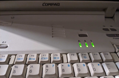

I have a Compaq Armada 7770DMT laptop, when I plug in the power cord, all three lights stay ON.
Pressing power button does not turn on the laptop. Tested with hard drive and without.
Does it mean the motherboard is broken?
Is there anything I should try?
Thanks.

may have got a power-shock , try removing everything (battery , hdd , ram,power from circuit by holding power button for more than 1min ) and use a good known power adapter. If it beeps , than you may have a chance. If not you need soldering skills to fix motherboard
It can be first resistor , or mosfet or regulator or something. (I have one laptop that had a spiked power adapter on me,at-to 20v and it need-ed 9v or something and still was not able to fix her yet. 91 model.)
is this COMPAQ with integrated poweradapter? may have issue in that... (separate part attached to motherboard).

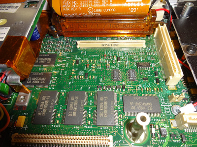

I managed to open the laptop. It looks like corrosion near the CMOS battery connector.
I did try to power the laptop without CMOS battery, hard drive and floppy drive. It shows the same symptom - all three lights stay ON.
Do you know if all the Compaq Armada 7700 series uses the same motherboard?
I think I will buy another 7700 from eBay and replace the motherboard.

Reply 9 of 12, by ediflorianUS
sangokushi wrote on 2023-06-08, 10:40:
I managed to open the laptop. It looks like corrosion near the CMOS battery connector. I did try to power the laptop without CMO […]
I think it's close , clean with contact cleaner and check the L4p diode... *may be bad. (is te fuse ok next to C662)
I will check my collection see if I have any 7700series but I don't think I have.

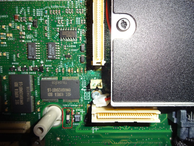

ediflorianUS wrote on 2023-06-08, 13:06:
Can you tell me where is the L4p diode?
The fuse is ok (I assume it's the component in the circle)
I googled search and found the motherboard board part no: 291736-001 https://www.elhvb.com/mobokive/edwin/laptops/ … mpaq%207710.pdf
I thought 7700 series are using the same motherboard, but the part no. are different.
I just setup an eBay search for 'untested' + 'power on', + '7770DMT' and hopefully a cheap one will come up soon.
Thanks for your help!

Reply 11 of 12, by ediflorianUS
it's str8te up from the fuse , It seemed oxidated , and located where can be bad but maybe I am wrong. Anything in particular warming up to HOT? on the MB? Maybe try checking the oxidated traces/may get lucky and one(or two) is interrupted
