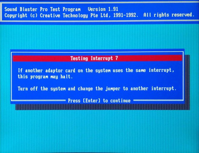

Reply 287 of 518, by RayeR
I tried to set LPT as LPT2 with IRQ5. I wonder why but then sound doesn't work at all. After running SAPPHISA with defaults neither HWINFO nor ESSCFG nor Unisound can detect the soundcard via PnP. HWINFO shows that IRQ5 is used by LPT only.
I know that I can't expect modern MB IRQ legacy options in SETUP but I though if possible to alter it by some PCI registers programming or something like that...
So it seems the only way is to use shared IRQ7 with enabled LPT1.
I found that the Boost demo has "-m" command line option to run manual Midas config. After I manually set IRQ7 I got sound 😀
But it's not the case of Zdoom for DOS, I cannot find such option, only the -nosound
I would need some way to unregister the LPT IRQ after boot - superIO? PIC/APIC?

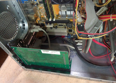

>nakos1212
Probably not, not now...
When placing the bridge chip behind the ISA slot it would make routing harder.
I plan to mount the adapter this way at bottom side of case with ISA card just close along to the left case side. And I drill some hole for jack at back side. This is just for example some common minitower (not one I want to use) and there's enough space so I don't see any problem...

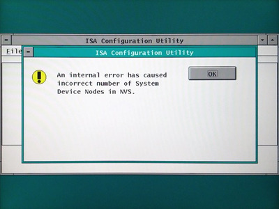

* I tried to run intel ICU utility to get some info about ESCD but it failed. Resp. when I put DWCFGMG.SYS driver in CONFIG.SYS then it filled some data to C:\ESCD.RF file but after I run ICU.EXE I just got this error and it exit. But I think the old SBPro Test could run also on 386 and it's not ESCD/PnP aware...

Next step further.
I managed to disable LPT device block in SuperIO after boot via ISADUMP/ISASET utils ported from Linux to DOS by my friend Ruik
http://rayer.g6.cz/download/download.htm#ISADUMP
# konfigurační klíč:
isaset.exe -f 0x2e 0x87
isaset.exe -f 0x2e 0x01
isaset.exe -f 0x2e 0x55
# volba logického zařízení č. 3 (LPT)
isaset.exe 0x2e 0x2f 0x07 0x03
# vynulování CR 30h
isaset.exe 0x2e 0x2f 0x30 0x00
# výpis všech registrů logického zařízení č. 3 pro kontrolu
isadump.exe -k 0x87,0x01,0x55,0x55 0x2e 0x2f 3
After this HWINFO stopped showing LPT and in IRQ list it shows IRQ 7 as free. The SBPro Test program stills cannot find IRQ but programs using MIDAS library can! So I got sound from Zdoom (no config avail.) and Boost without manual config.
