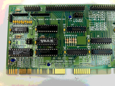

Looking at the Winbond VL400GW/S1336, seems like the card doesn't have a dedicated IC for the IDE controller.
578.64 KiB
1172 views
Reply 28 of 262, by debs3759
It's also ISA, not VLB

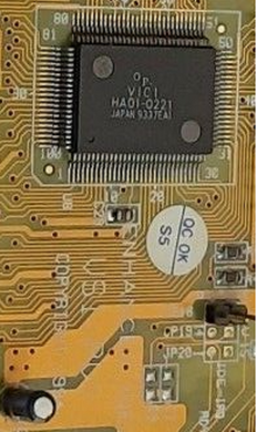

I saw this chip on a VSI-PV1 VLB board for sale on ebay:
194.42 KiB
1119 views
Would the manufacturer be VIC and the part number HAOI-0221 ?

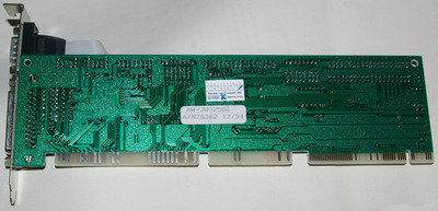

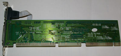

Pictures of my VL-IDE controllers:
Promice PDC20630-based controller:
821.91 KiB
1091 views
762.49 KiB
1091 views

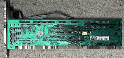

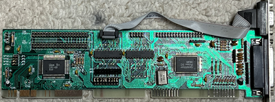

UMC8672F-based controller:
931.84 KiB
1091 views
909.76 KiB
1091 views

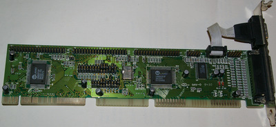

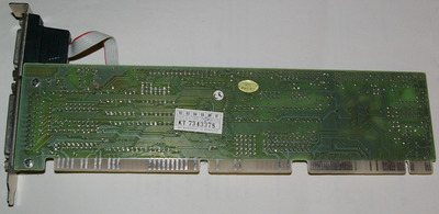

... Winbond W83759F-based controller:
962.51 KiB
1091 views
926.45 KiB
1091 views

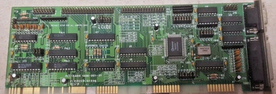

I got this in the mail today:
1.39 MiB
1053 views
1.09 MiB
1053 views
Someone has a bunch of them on ebay.
I put the drivers here:: http://www.vogonsdrivers.com/getfile.php?file … menustate=56,55

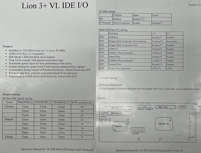

Along with this manual:
597.91 KiB
1050 views
The write protect jumper is kind of unique.
Looks like all of the data lines are connected, so 32bit transfers seems plausible.
Looks like it should do at least PIO3 speeds, but "IDE Mode 3 IDE Hard disk support is a little vague"
It's got 8 speed settings, but I don't understand what it means by "R/W cycle(clock)".
Reply 36 of 262, by pshipkov
R/W cycle(clock) = wait states.
The smaller this number is, the better.
Also, it looks like the driver and jumpers mirror the same functionality - you can set speed with the jumpers and not use the driver.
But, looking forward to hear more about this guy. Share some details once you test it.
retro bits and bytes
Reply 37 of 262, by mkarcher
pshipkov wrote on 2023-04-23, 06:31:
If it says "cycle", these numbers probably specify the "cycle" time. That is the time between the start of transferring one 16-bit word to the time of transferring the next 16-bit word. It consists of the "active" time, that is the time when the control signals for read/write are active, and the "recovery" time, that is the duration between the end of one data transfer and the start of the next one. To correctly implement a PIO mode, both the active time and the recovery time need to be no shorter than specified by the ATA committee, so just calculating the cycle time from the numbers given here does not necessarily imply that the controller fully complies with a PIO mode having the same cycle time. "(clocks)" refers to the unit in which the cycle time is given, in this case the duration of the VL clock period. The VL clock period is 30ns for 33MHz FSB, 25ns for 40MHz FSB and 20ns for 50MHz FSB. So the table from the manual for that Lion 3+-based card can also be written as
Speed number    cycle time (33MHz)    cycle time (40MHz)    cycle time (50 MHz)
0 1080 900 720
1 960 800 640
2 810 675 540
3 690 575 460
4 540 450 360
5 420 350 280
6 270 225 180
7 150 125 100
It is likely that speed 6 at 50MHz resemble PIO3 timings well enough to be working with all PIO3 drivers. Speed 7 exceeds PIO3 already at 33MHz, but might work outside of specification with many PIO3 drives and all PIO4 drives.
