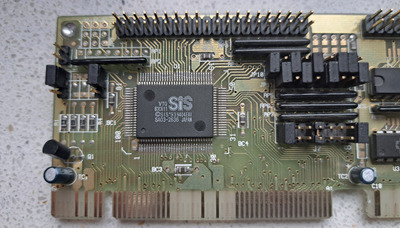

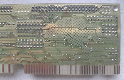

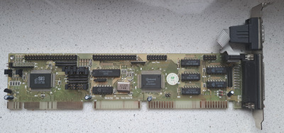

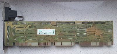

Hi, actually Peter's card is currently with me. So below I present its photos.

    bottom side - ide part

    bottom side - whole card

    top side - ide part

    top side - whole card

That's a curiously stripped down card. The chip should support 2 IDE headers, but it ain't there on your board.
I've got a SIS611 card and a SIS601 card. On both boards, the jumper to disable the second IDE controller is the right most jumper on a bank of two pin jumpers. So maybe removing the right most jumper on J7 would do it for you.
p.s. Curiously, the SIS601 is the newer chip, fab week 95-03, while the SIS611 chips I've seen have had 93 fab weeks. Seems like SIS, along with several other VLB chip makers, came out with new chips in early 1995.
