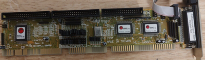

I took a risk and acquired this board:
544.75 KiB
1122 views
Turned out that there was a PDC-20630 controller under that sticker, so that counts as a win!

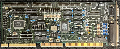

Reply 85 of 262, by Intel486dx33
What about this one. It’s a Mystery to me. I bought it NEW on eBay but I can’t find any drivers or jumper setting or documentation for it.
Its a “Acculogic sIDE-4/VI”
    975.27 KiB
    1104 views
Reply 86 of 262, by Disruptor
Intel486dx33 wrote on 2023-04-28, 19:34:
Oh, it has ISA IDE and VL IDE. So you have one slow and one fast port on it.

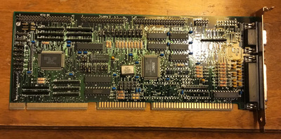

Reply 91 of 262, by douglar
Intel486dx33 wrote on 2023-04-29, 08:34:
Can you post a photo of your jumper settings ?
Acculogic sIDE-4/VL (pretty sure that's an "L" with a via through the letter, not an "I")
https://fccid.io/IIV0041900A00
Jumpers are close to this: https://arvutimuuseum.ee/th99/c/A-B/20956.htm
But the card is Rev C and has that additional bank of jumpers down the left side that look similar to the manual speed selector jumpers seen on other boards from this period.
Is there a wayback website for Acculogic PC parts? Acculogic.com seems to be for something else.
511.06 KiB
1026 views
Looks like the traces are there for an enterprising modder to add a rom at U4 and address jumpers at JP23. Probably also need to add a SN74LS138N decoder at U15 and a GD74LS244 line driver at U9, yes?
Looks like you could add a game port at J8 if you added chips at U12, U13, & U5. Don't know what those parts would be. Probably need to add a bunch of resisters and capacitors in the corner too.

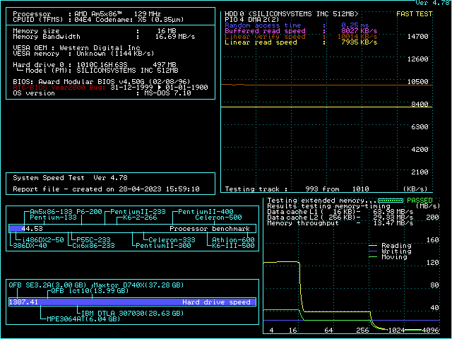

I hope this is meant to read "8MB/s to 8.5MB/s" throughput. 8 KB/s sounds more like what an original IBM PC (1981, model 5150) can get as net application performance from a floppy drive.
Yikes. That's always embarrassing. You are correct. I was getting 8000 KB/s on a 512MB CF and my brain auto corrected the second KB.
9.98 KiB
1026 views
Yes, I'm using a cruddy performing mobo for testing right now. I could have sworn the WB cache was working on this guy once upon a time.
https://theretroweb.com/motherboards/s/fic-486-vip
I'll switch to a better board later on, but I soldered a PS/2 mouse onto this one and it works with my KVM switch so it's pretty convenient and it's been rock solid stable with the updated rom and new battery.

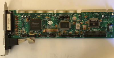

I need a driver for the Controller - DTC-2278D, VLB ( 2 channels ).
that offer support for hard drives larger than 420mbs.
Reply 98 of 262, by douglar
Intel486dx33 wrote on 2023-04-30, 03:59:
Under that sticker should be a DTC 803 chip that supports PIO-4
This looks like the last driver made for the board:
http://vogonsdrivers.com/getfile.php?fileid=1 … &menustate=55,0
It’s from 1998 and they had larger drives then, but the bios that boots your computer likely has some say in the matter first. If you Bios is older that Sept 1994, you likely need a bios extension like Xtide Universal Bios or you need drive overlay software installed on the boot sector of your storage device
