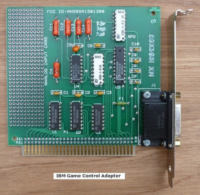

Hi everyone, I think the root cause is that the IBM Game Control Adapter™ was meant to be versatile.
Originally, maybe, there was a need to replicate paddle support, like with pong consoles.
The C64 had X/Y inputs (via SID), too, for that purpose same (paddle support). They were later repurposed to interfaces mouses, err, mice.
On the original IBM gameport card, there's a provision for custom circuits:
At the end of the card, there's a veroboard-like section..
132.62 KiB
599 views
Source: https://minuszerodegrees.net/5150_5160/cards/5150_5160_cards.htm
Edit: There's another version with a provision for a second DE15 port.
I'm just mentioning this, because the gameport was the #1 experimental port of my childhood (QB45, VB1 on Windows, Turbo Pascal etc). 🙂
Out of all ports, it was the most plug&play type one. You could remove/add cables on the fly to it without worrying.
Because, the buttons were just switches anyway and the X/Y axises were meant to see varying resistance/conductivity.
This meant that almost everything from zero to max was being accepted on the inputs.
A short (buttons) or sudden power/voltage spike (axes) was essentially part of the design.
