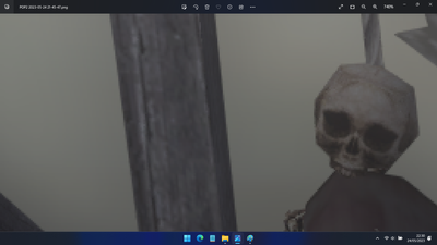

Will definitely try to do something with it. Found the topic, will take a look. Also, there is mrhaandi's injectSMAA, which I think might work as well. Do you know any way I can take a screenshot of the internal resolution image before the downsampling? That would help evaluate the usefulness of SMAA in a 3840 x 2160 image. From my head, I think it would eliminate ANY leftover jaggie in a resolution so high.

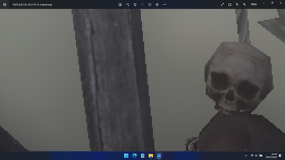

EDIT: forget about SMAA, I just tested Warrior Within @ 3840 x 2160 in my 4k TV. The winner is: FXAA with preprocessor quality preset 39 (ReShade shader). SMAA takes about 0.950ms in 4k, FXAA 39 takes 1ms. Here are the comparison screenshots:

In this scene, there's virtually no difference between SMAA+FXAA and FXAA only. Had to test with the original DX9 renderer, because dgVoodoo2 was giving me a textureless-white-washed render, dunno why. It works in 1080p.
So, after rendering internally @ 4k and applying FXAA 39, that would be the best image quality for a downsample, which would remove ANY jaggies in the final result. I know, downsampling from 4k-only virtually removes all jaggies, but we can see in those screenshots that if you zoom hard enough, you still can see improvement with FXAA/SMAA turned on.
About the texture blurring of post processing/temporal antialiasing methods: proper SMAA doesn't blur like the other methods. Even FXAA, if set with a high enough quality, won't blur that much: you can test it with ReShade's own old FXAA method (EDIT: set preprocessing FXAA_QUALITY__PRESET variable to 39, and the blur will be almost non existant). You can get an overkill antialiasing method in ReShade turning on SMAA and FXAA at the same time (SMAA first, FXAA after). It does work, performance hit is minimal (EDIT: on 1080p: both SMAA and FXAA are only 0.350ms or so each, total about 0.700ms), and you won't notice any blurring unless you're looking really, really hard. Also, this blurring can be easily countered with iMMERSE Sharpen or AdaptiveSharpen (great sharp shader, but old and obsolete now after iMMERSE). SMAA+FXAA first, sharpen after.

FXAA / SMAA does blur, I see false positives in that screenshot where it does smooth out things that aren't aliased geometry edges. That screenshot is 4K which is best case scenario, 1080p is worse. Sharpening afterwards just further deteriorates the image.
SMAA is good because it's cheap, not because it's high quality.
