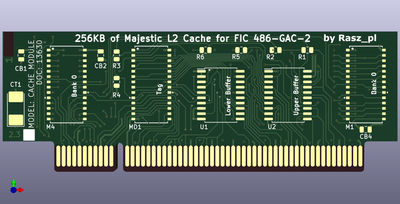

Reply 81 of 121, by rasz_pl
majestyk wrote on 2024-02-28, 21:25:
This should be easy to fix in layout "Rev. 1.1".
rev 2.3 now :]
DOC13630 has copper 2.0 designator in lower right corner.
Yours has 2.1.

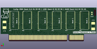

Funny prototype miisalo managed to fix for RockstarRunner was 2.2. Height when inserted 28.2mm, height including slot 35.6mm.
Github updated. For 2.3 I decide to bite the bullet and shrink it as much as possible without being painful to reroute, it should be almost the height of original. I also made tracks and silkscreen text slightly thicker and worked on clearances. Height when inserted 26.3mm, height including slot 33.6mm. Bigger cap footprint is still too big.
69.17 KiB
481 views
70.02 KiB
481 views
Now I need confirmation size selection works as described, someone with whole Globalyst computer measuring if it fits with floppy on top, and absolute premium would be majestyk testing FIC 486-PAK-3 for compatibility.

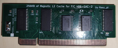

Reply 82 of 121, by RockstarRunner

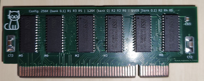

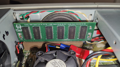

What I can say about current proto I have now:
With some sanding, it will insert ok, but fit is tight.
Divider is ok, marks on fingers indicate good alignment, do not recommend shrinking the gap.
miisalo was managing to solder the rams ok, particularly after doing couple of chips, but observed that making the pads bit bigger would ease the job.
Globalyst 510 has floppy on opposite side of case, clearance is not an issue with this machine.

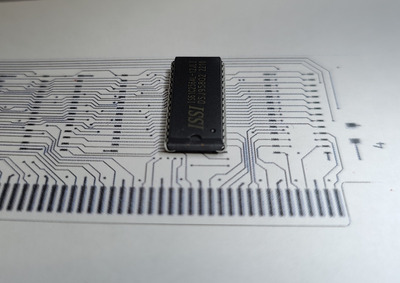

Reply 83 of 121, by miisalo
RockstarRunner wrote on 2024-02-29, 09:54:

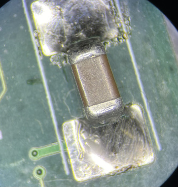

Yeah, pads need to go more under the chips as curved pins are not even touching the pads and I had to bridge them with solder. I have really good stereo microscope up to 40x so it wasn't so hard but still had to inspect every chip and fix few connections afterwards. With bigger pads, using paste would work too.
35.02 KiB
455 views
Btw, those ceramics just needed bit of creative soldering to connect the pads made for tantalums 😁
476.96 KiB
455 views
Reply 84 of 121, by RockstarRunner
825.45 KiB
442 views
Proto side 1
872.19 KiB
442 views
Proto side 2
1.54 MiB
442 views
Proto in Globalyst 510
Reply 87 of 121, by rasz_pl
miisalo wrote on 2024-02-29, 11:02:
So the footprint is too wide despite being the dedicated one downloaded from digikey https://www.digikey.fi/en/models/1555403 for this very chip 😐 7.6mm inner distance while 61C256AL datasheet demands 6.2-7.3. Its almost like this chip is made for SOIC-28 footprint.

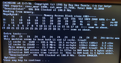

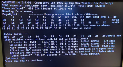

Prototype Test Results
| Benchmark | No L2 Cache | 256K L2 Cache | Percentage change |
| 3DBench Slow | 52.6 | 66.6 | +26% |
| 3DBench Fast | 50.0 | 62.9 | +26% |
| Chris's 3DB | 34.2 fps | 38.3 fps | +12% |
| Chris's 3DB VGA | 10.3 fps | 11.5 fps | +12% |
| PC Player | 14.1 | 15.8 | + 12% |
| PC Player VGA | 5.3 | 5.5 | +4% |
| Doom Max | 29.8 fps | 35.9 fps | 20% |
| Quake TD | 9.5 fps | 10.3 fps | +8% |
| TopBench | 218 | 256 | 18% |
| SysInfo CPU | 128.0 | 198.1 | +55% |
Memory speed measurements
| Cache Check |
No Cache ....| L1: 101, Main: 30.1
256K Cache | L1: 102.7, L2: 42.9, Main: 21.1
| SpeedSys |
No Cache ....| Mem Band: 76.15, CPU: 39.27, L1: 58.55, Main: 29.55
256K Cache | Mem Band: 47.37, CPU: 42.67, L1: 66.4, L2: 37,5, Main: 23.9
All in all, some pretty appreciable improvements, such as 20% improvement in Doom, nice!
Importantly, the external cache mode should be set to Write Back, such as this module supports, otherwise improvements are marginal if set to Write Through.
I seem to have taken a hit to system memory bandwidth after adding the cache, maybe some bios settings need tweaking.
Cache Check reports 19 clocks, up from 13.3 clocks without cache
@majestyk can you send me your bios settings for your GAC-2 ?
I will update these results, if I find a solution for this.
I did manage to make it a bit better, see post below
1.18 MiB
372 views
Cache check
1.19 MiB
372 views
Speedsys
I'm not sure if it's possible to tweak it, I think I've read somewhere it's a quirk of the VIA chipset when using L2 cache. But maybe you'll come with something surprising 😉.

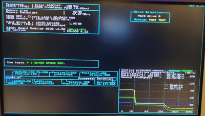

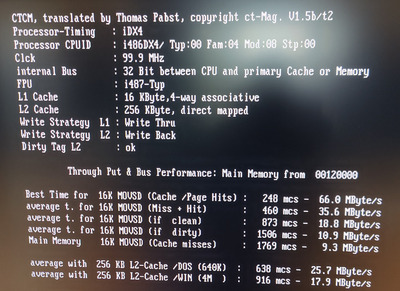

Reply 90 of 121, by RockstarRunner
Setting cache timing to Turbo improved things a bit (previous tests were set to Fast)
SpeedSys
Memory bandwidth: 55.04
System score: 42.67
L1: 66.6
L2: 43.89
Main: 24.93
Doom max: 37.2 fps
Quake TD: 10.6 fps
This gets me right about Majestyk's scores posted on page 1
1.28 MiB
348 views
CacheCheck_Turbo
I'm going to run ctcm when I get the chance, to see if the tag is behaving, as that seems to be a typical reason regarding wb cache and nerfed memory bandwidth.
888.58 KiB
325 views
Ctcm15b
Yep, that's not the issue, oh well, it's another confirmation the cache module is working.

Reply 95 of 121, by rasz_pl
RockstarRunner wrote on 2024-03-01, 18:36:
Chip on 2.4 paper version
Looks like legs finally land in middle of pads and its perfect for hotplate/hotair/oven soldering, but will still be a PITA to someone with only soldering iron. Slowly getting there, Ill make pads slightly longer 😀 There is ample space. Now that I got familiar with the design I could probably cram it all in at half the width of original module 😜 Ill also move few caps around, CB1 CB2 and CB3 are so close to each other two of them dont contribute anything.
Maybe last try:
bigger pads on sram footprint, should be hand solderable now
height 26.3mm -> 25.9mm
small caps redistributed, one big cap removed

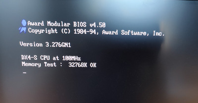

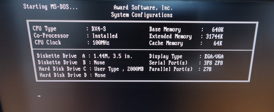

Reply 96 of 121, by RockstarRunner
Results of 64/128KB configurations
Sorry this has taken so long.
This is what happens when I configure the jumpers to 64 and 128, with the full set of srams installed (just like 256k mode).
64
780.88 KiB
241 views
64config
64kb is recognized, but the system just sits there before actually running config.sys
128
352.74 KiB
241 views
128cinfig
System just sits there after performing memory count.
Is the problem that you would need to install the correct SRAM configuration according to jumpers, or does the selection simply not work?
Reply 97 of 121, by majestyk
The populated chips must match the jumpering, just like when the chips, buffers and jumpers are on the mainboard.
Basically there´s no reason to use less than 256K, the TAG address lines are 7+1 for dirty TAG so we have only half of the cacheable area available.
Reply 98 of 121, by rasz_pl
Im pretty sure I got half the cache working on wrongly jumpered board once. Will have to look at the diagram and ponder this some more.
