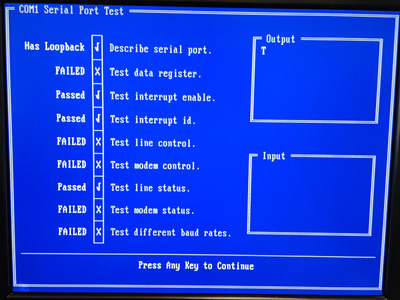

Reply 55 of 144, by pshipkov
Forgot to respond to the CheckIt3 test status request.
Everything comes clean.
But the serial ports test looks like this.
Result is the same when run the test on computers where the serial ports work (with the same controller), so not sure how indicative this test is.
retro bits and bytes

Reply 58 of 144, by Deunan
pshipkov wrote on 2023-06-19, 20:27:
I think this test requires some loopback dongle to be connected at the serial port. I don't see how things like line control could be tested otherwise.
Did you try to connect pins 2 and 3, and running terminal program or this kind of test? BTW do pay attention to the pin numbering, no damage will occur from short-term shorts on any of the serial port pins but it's better to avoid them. I'm mentioning this because the voltage measurements you did only make sense if you tested the pins in this order: 5-4-3-2-1 and 9-8-7-6. If you are sure you went from pin 1 up then perhaps you are using some incompatible serial port socket+cable combo.
Reply 59 of 144, by TheMobRules
I provided a link to the loopback specs earlier in the thread.
CheckIt can do a more limited test of the COM/LPT ports without the loopback but you have to respond 'N' when it asks if you have the loopback connected before running the test.
