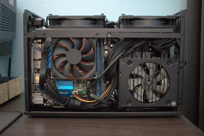

  • Case: FormD T1 (sandwich v2.0) (w/ 2x Noctua 120x25mm exhaust fans)
  • Motherboard: ASRock Z97E-ITX/ac
  • CPU: Intel 4790k (w/ Coollaboratory Liquid Pro TIM)
  • CPU Cooler: Thermalright AXP90-X47 Full (w/ Noctua 92x14mm intake fan)

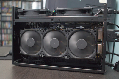

  • GPU: GIGABYTE GTX 980 Ti G1 (deshrouded w/ 3x Noctua 92x14mm intake fans)
  • Memory: 16GB (2x8GB) G.SKILL F3-1600C9D-16GXM
  • Power Supply: 750w Corsair SF750 SFX
  • SSD: 2TB Samsung 870 EVO (IDE mode)
  • Sound Card: Creative Sound Blaster X-Fi Titanium
Notes
This system triple boots Windows XP Professional (32-bit), Windows 7 Ultimate (64-bit), and SystemRescue and uses GRUB as a boot menu. I temporarily connected a SATA DVD drive to perfrom the Windows installs (unmodified Microsoft discs). The fresh installs (no drivers) were then backed up using SystemRescue to hopefully avoid needing to reconnect the optical drive.
Everything works flawlessly. Temps never exceed 65C (CPU & GPU) and the system runs fairly quiet (except for the GPU's coil whine under heavy load).

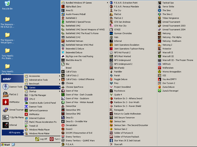

All of these were installed via disc images and Daemon Tools. All working without issue.

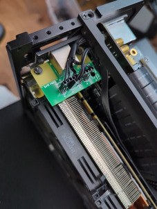

    The motherboard only has a single PCIE x16 slot, so I connected the X-Fi to the mini-PCIE slot via an adapter.
    277.51 KiB
    2768 views

Reply 1 of 16, by Standard Def Steve
OMG, I think I love your computer.
You've absolutely nailed it in every way, from Devil's Canyon to the 980 Ti driving that awesome CRT. Even the SSD is right up there at MBR's maximum 2TB capacity limit. And you even have the Classic theme going so that XP's intense visuals don't bog down your 4970K! 😜
Just 10/10, man.

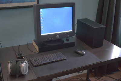

Reply 2 of 16, by Cosmic
This is insanely nice. I love & hate that your specs are almost the same as my daily driver 😂 this is a gorgeous build and I see a lot things I would have done the same way which makes me really love it. It's small, clean, the desk setup and CRT are excellent. Software side is very clean as well and I see a lot of my favorite games in your games folder. Another 10/10 from me.
What resolution/refresh rate do you run the monitor at? I bet it's extremely snappy. I remember using those at school and they're really solid.
Reply 3 of 16, by bbusse
I love this. I've had this motherboard sitting around with a 4790k for a long time trying to decide what to do with it. I think i found my plan haha. Although i'm not gonna deal with a SFF case, but i'm very into retro builds and have 486, Pentium Pro 200, AMD K6-2 550 (2x Voodoo2 12mb), etc... and i just don't have an XP build. I think it's time 😀
Do you have specifics on the mini pci-e extension cable used for the sound card? I've never used one and there are plenty out there to buy. Which did you use?
Reply 8 of 16, by GokuSS4
how did you get that PCIe Card working?
do you use something like this?
https://www.adt.link/mpcie.html

Reply 9 of 16, by nvllsvm
bbusse wrote on 2023-08-01, 03:06:
GokuSS4 wrote on 2023-11-13, 01:10:
I used a Mini PCI-E to PCI-E adapter - specifically this one: https://www.amazon.com/gp/product/B07SWX4C5B .
I used two PCI-E 1X extension cables to connect to the sound card. Could have used a single, longer one, but meh - this works and looks good enough. https://www.amazon.com/gp/product/B07J2BJPDN

Reply 10 of 16, by nvllsvm
Cosmic wrote on 2023-06-16, 16:44:

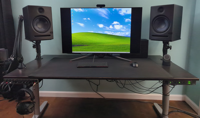

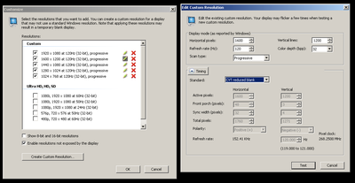

I was running at either 1024x768@85hz or 1280x1024@75hz. The monitor could handle both, but the 980 Ti's analog output can have noticeable artifacts depending on the frame rate (wavy lines).
However - I recently upgraded my main PC's display to an ASUS ROG PG42UQ OLED (firmware v040) and decided to also switch this SFF XP build to it. I particularly chose this display as it's one of the only OLED's with a DisplayPort and Linux is my main OS. AMD's Linux driver doesn't have full support for HDMI 2.1 and cannot output full RGB 4k@120hz with VRR - thus my main rig is connected to the DisplayPort.
I have the SFF XP rig connected using a DisplayPort 1.4 to HDMI 2.1 adapter. Downgrading the NVIDIA driver from 368.81 to 355.98 exposed the ability to add custom resolutions in Windows XP. I primarily use either 1600x1200@120hz or 1920x1080@120hz depending on the game.
All in all much nicer than the CRT I used previously. No analog artifacts, much higher resolutions/refresh rates, and frees up some office space. I also managed to connect my WIP Quadro 980 XGL and Voodoo 5500 build to this display without issue (both over DVI to HDMI). More on that in the future in another post...

Reply 11 of 16, by Cosmic
nvllsvm wrote on 2023-12-16, 22:13:
I was running at either 1024x768@85hz or 1280x1024@75hz. The monitor could handle both, but the 980 Ti's analog output can have […]
My goodness that's a setup. I've never seen XP on an OLED. You're really taking this to the max, not just in specs but the whole setup is extremely clean. Nobody could have had such a nice setup at the time.
What do you do with the monitoring speakers? Just listening to music? They look super nice. I've always been a fan of nice discrete audio. I previously rocked Emotiva XM4s + Indeed Audio class T amp + FiiO DAC + Xonar PCI card over TOSLINK. It was a badass setup.

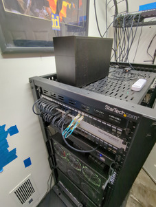

Just added a PiKVM ATX control port so I can relocate the system to my server closet about 50ft away. The 980 Ti's coil whine no longer bothers me 😆.
New external components:
