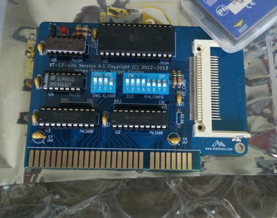

So can I just get any ISA IDE card and call it a day or should I consider something I don't know of?
Also thank you for you all who have helped me so far!
EDIT again: The older bioses, do they support any kind of IDE controllers? There are ISA CF controllers, would these work for me? I am concerned of the proprietary bios that it might not support anything beside the original manufacturer parts.

Reply 8 of 23, by Jo22
Hi again, this old thread might be helpful, too.
At the end, there's a link to a backup of the setup disk.
HP Vectra QS/16S
Good luck.🙂🤞
Edit: Yes, most (if not all) PC/AT compatible PCs do support IDE.
That's because IDE is like a superset of MRM/RLL controllers (it adds HDD identification features etc).
But the core functionality is same, no need to worry.
Now to the "problems": The old IDE standard was in use up until 1994, roughly. After this, subtle changes appeared (ATA-2 specification).
So depending on how old the PC BIOS, problems can happen.
For example, my Schneider Tower AT 286 (also shipped w/ MFM HDD originally) was hanging when I tried to use an ISA IDE controller card and an CF card via adapter.
However, it wasn't an electronic problem.
If I changed the HDD type to "none", it booted from floppy.
My solution was to leave it that way and use XT IDE Universal BIOS instead.
It's much newer than the ancient MFM/RLL HDD routines in the 1988 BIOS.
I had no problems since.
Edit: Typo fixed.

If the BIOS doesn't support the necessary HDD settings, you could trying using an XTIDE BIOS extension to enable support.
I do this with a few 286 computers I have that don't support custom HDD settings. I use the Lo-tech ROM cards with an XTIDE BIOS.
