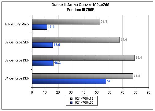

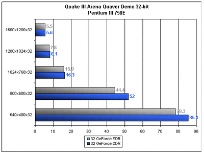

Reply 45 of 54, by The Serpent Rider
this all thing started because I was afraid the 32MB on the gts wouldn't be enough for some later games.
Well, in fact, even your bog-standard Quake 3 Arena had maps which oversaturated 32Mb memory in 32-bit color, although not by much in low resolutions and only with uncompressed textures.
Here's an example from GeForce 256 SDR/DDR comparison (courtesy of anandtech):
12.35 KiB
924 views
Notice very sharp performance drop at 1024x768. That's when AGP texturing could not help poor 32Mb cards to deal with constant memory swapping. Lower resolutions are also affected.
And here's the same test, but with GeForce DDR 64 Mb:
11.05 KiB
920 views
You can deal with it by using 16-bit color or with texture compression, where available, at the expense of texture quality.
