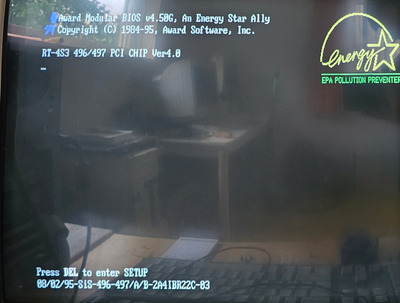

I have a motherboard which indicates in my post that it is a RT-4S3 the board is also known as KM-S4-1
Here's a picture of my post
Can someone tell me which version I have on it now and whether there are also newer versions for this motherboard and if there are newer versions what they improve?
I have an Am5x86-P75 133mhz on it and it is recognized as a dx4 120mhz and hope through a bios update that it is recognized as an Am5x86-P75 or is there perhaps something else to do about this?

Hi egbertjan,
From your picture I can see that you have the Version 4.0 BIOS with a 08/02/95 date.
These August 1995 Award BIOSes didn’t have Am5x86-P75 support, but they do support the Enhanced Am486DX4 CPU.
There is a later Version 4.2 BIOS for your board that can be downloaded from:
https://theretroweb.com/motherboards/s/rectro … t-4s3#downloads
I’ve checked this 10/30/95 BIOS and it has indeed Am5x86-P75 support! 😀
This BIOS is just 3 month newer, so probably won’t have any other improvements than Am5x86 support.

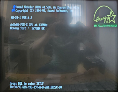

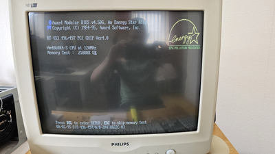

From Chkcpu I received a chip with an update for the BIOS. I mounted the chip on the board and the result was completely OK as you can see on the photo's. The AM5x86-P75-S is now correctly supported. I am realy happy with this result.
Before update:
1.26 MiB
533 views
After update:
682.56 KiB
533 views

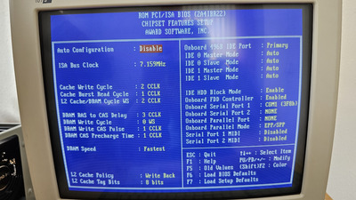

Before update:
1.62 MiB
528 views
After update:
1.94 MiB
521 views

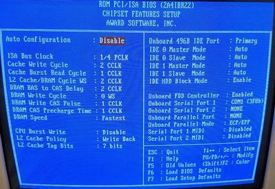

After the update there was an extra setting in the BIOS: CPU burst write. Can someone tell what this is about and should it be dis- or enabled?
Reply 9 of 9, by Chkcpu
I know that Cyrix 486DX(2)(4) and Cx5x86 CPUs have a “Burst Write Cycle” feature that can be enabled or disabled via software. The “CPU Burst Write” option you see in the new v4.2 BIOS probably controls this Cyrix feature.
Enabling Burst Writes should increase performance but if it is a Cyrix only feature, it won’t do anything on AMD and Intel CPUs. But you can always try enabling it on your Am5x86 and see if it makes any difference. 😉
